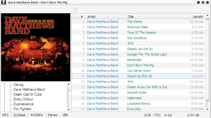

This is my foobar.
Does anyone know how to get the album list over the playlist? So that the album art is the only thing to the left...
varland, in order to achieve that please refer to my small guide below ;)
Step 1.. make sure you do this first
Step 2.. then, right click anywhere on your toolbar and click on that
Step 3.. and you will get this
Step 4.. if the album list doesnt appear to your liking, you will need to adjust it here
good luck and happy foobar-ing! :cool:

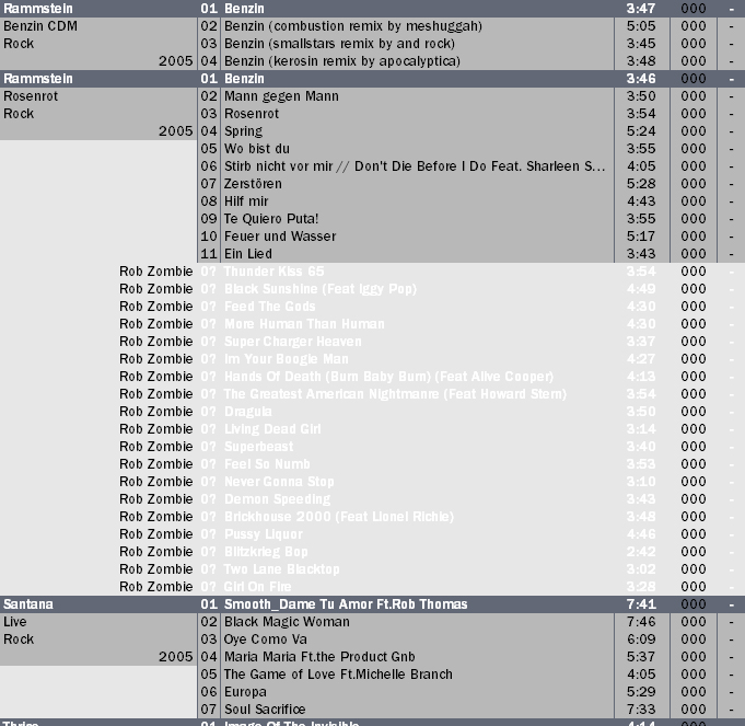

I'm having a problem here. Some of my albums/songs have only id3v1 tags, those ones don't work properly with the grouping. The albums/songs that have both look normal. This happens with every config file I try to use that has grouping. Anyone know how I can fix it without editing any tags?
Edit: I tried taking 3 copies of an album and making one have both sets of tags, the other with v1, and the last one with v2 only. They all displayed perfectly. Not sure why the other ones don't work, all I know is that they only have id3v1 tags.

I figured it out, it's the track numbers. When there isn't any it doesn't look right. Anyone know a way of making it work without putting track numbers into every mp3 that doesnt have them?
From my experience, no. You have to go through and apply the TRACKNUMBER tag manually. :(
No, that config needs tracknumbers to work. It works by displaying the artist beside the first track of the album, the album name beside the second and so on. The only way Foobar knows its the first track of an album is if the tracknumber equals 1.
