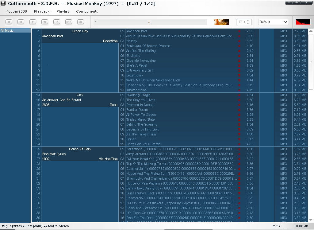

Maybe the above screenshot will better show you what I'm trying to accomplish. Eventually I want to have a completely color coded method of interpreting music metadata.
The RG and AG signify the presence of Replaygain and Album gain, respectively. Eventually they will be given their own columns using a solid green backgroud as indicating its presence, and a solid red background indicating is absence.
Basically, I want to be able to go through my collection, looking for any red, which will clue me into problems that I have with certain tracks.
I also want to design something more visually pleasing and that contains more information in the color when indicating bitrate (quality). It is for this reason that I do not like to use set values to determine the color that is displayed (i.e >128, >160, >192). It is for this reason that I chose the blend command.

EDIT: Updated Foobar. Green column is presence of RG. Far Right Column is Quality. Color of Track is Playcount. Purple Heart is presence of Ratings tag.

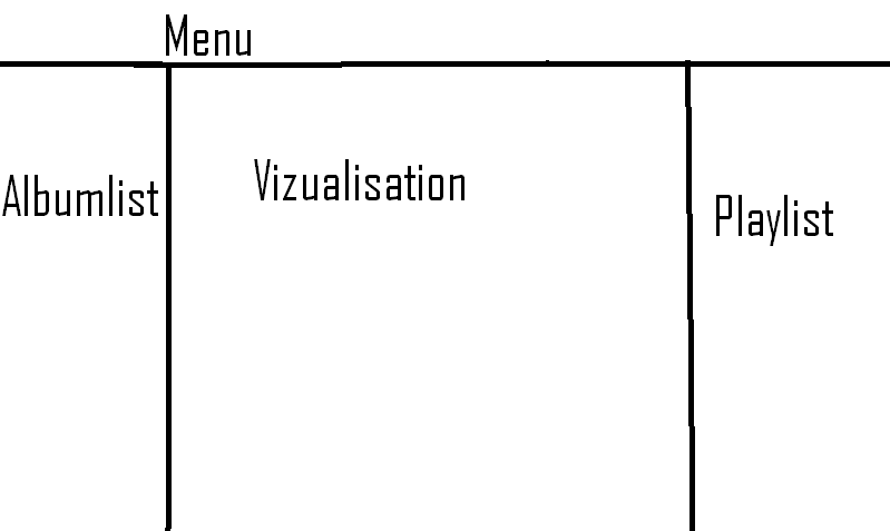

is there any possibility to divide the foobar appearence in 3 parts like the windows mediaplyer that at the left is the album list and in the middle the visualization and on the right is the playlist?
I've added a picture how i think it should become but i don't know how to realize this in foobar2000
