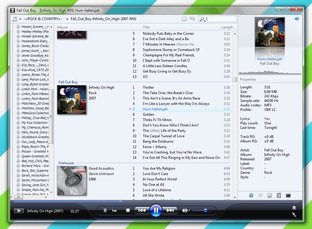

you guys need to check out this WMP 11 pui config.... it's one of the most in depth and useable configs i've ever seen.
http://www.hydrogenaudio.org/forums/index....st&p=446174
Woah, that's hot... Just wondering why he didn't use glass at the bottom...
