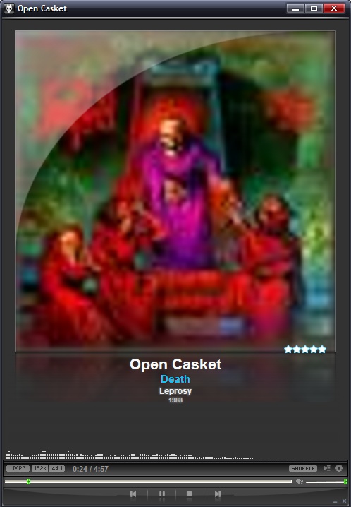

Heh, i know but i didn't have much time :whistle: so I've inserted full folders
"cwb hooks" for repeat button
"vis egoh" for nothing :p You are right, I forgot that now, in my foo, I have only spectrum analyser
Plugins needed for sure:
foo_ui_panels.dll
foo_cwb_hooks.dll
Thanks so much, I was missing foo_cwb_hooks.dll...but now everything works great!
Ok, once again.
Download link(images, .pui, components):
DOWNLOAD FOOBAR
Extract all to your foo main catalog and overwrite files.
Everything should be ok, because this time I included necessary components.
Enjoy!
Thanks mate, I cant open it as i'm at work and rapidshare is blocked. However from reading your post it sounds like you just zipped the program files folder, problem is your config isnt actually all stored there. its in documents and settings\application data\foobar2000 :) is this included in your zip file? if not no one is going to get the right output from using it.
I zipped only necessary images, components and PanelsUI config, not all files from foobar2000 catalog :p
