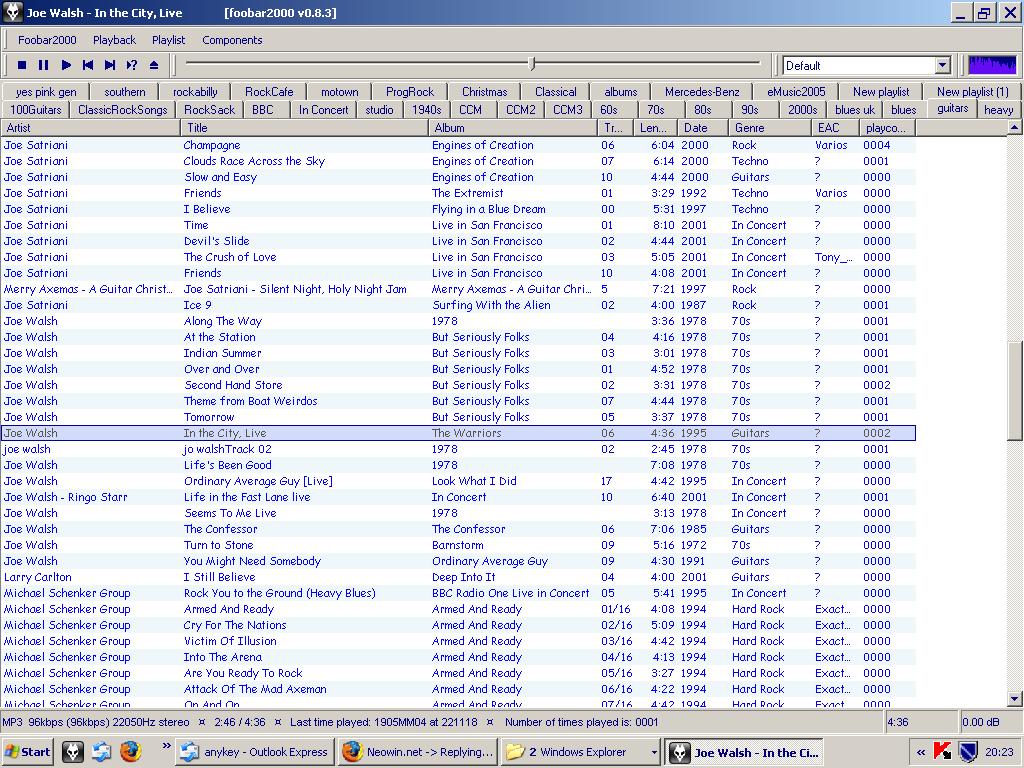

Thank you Krpano, this is better. I am now having trouble getting the Date displayed as I prefer. This is what I've got:
Last Time Played: 2101MM05 @ 221222
Whereas I would like to have Last Time Played: 21/01/2005 @ 22:12:22

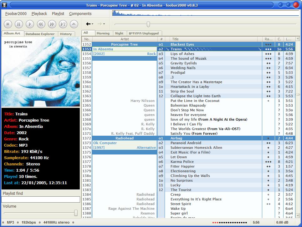

krpano, can i get your now playing panel code?
585363817[/snapback]
If you mean the trackinfo panel, here it is:

where exactly would i put this? thanx for your help
585365761[/snapback]
You need the trackinfo panel, in the preferences for that panel you will find an area where you can paste that code.
Thank you for all your help Krpano.
Here's what I've got now, and it's thanks to you. :)
585369060[/snapback]

Thats lot of playlist, how many songs do u have 100000 ?
:happy:
Btw, i see there you still have the playcount displaying date and time without : . / or whatever ?
Could not fix it ?
