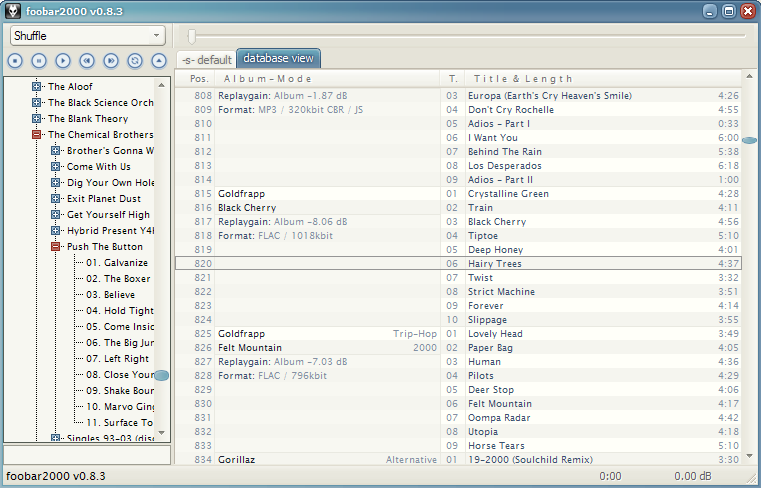

holy crap man you made it look good on the vs royal inspirat man that was impossible for me. Amazing man ! (Y)
585670658[/snapback]
Thanks. it wasn't too hard : foobar is customizable that way. just gotta jiggle it around so you don't get nasty seekbar like above screenshot. :laugh:
585671816[/snapback]
It doesn't bother me too much, RISE is a good enough theme where I'll put up with a few inconsistencies. :p

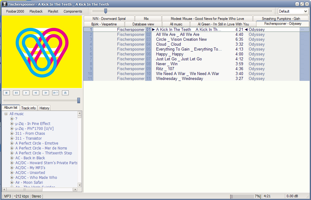

Ok.. here's mine...
I played around with different Columns UI scripts that would list the artist and album information all in the same column, but didn't like it. It just looked awful for any sort of Mix playlist because it would only show the artist on the first track, if the first track was there.
Anyway:
Columns_UI interface.
Album Art
Artist Panel
Tabbed Panel Stack
History Panel
Track Info Panel.
this is 1 1/2 days after downloading...
There's one thing I haven't quite found out how to do yet. Since I only use one playlist for all of my music, and just use database explorer to sort by artist/album. Is there a way to configure foobar, so when I add new music to my music folder, it will automatically update the playlist when it loads, and sort the artist/album correctly with all the others? The way I do it now is getting to be a hassle, because everytime I get a new album, I have to delete my playlist, and re-load all the files again, and with 5,000+ songs it takes a lot of time.
Help! :crazy:
