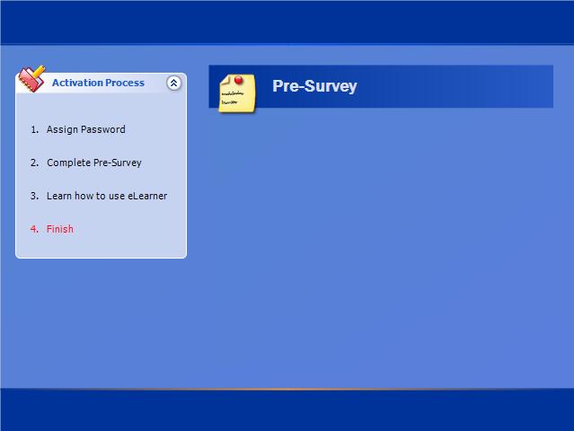

Basically, the user has to take a survey. The questions will be read from an xml file, with the question itself being assigned to a label. Next, the possible answer choices are read and are assigned to radio buttons. I've attached a picture of the form to help other people get:Dhe picture :D
Once I can get this connected, I could make the parsing recursive such that it keeps showing questions till the xml file is complete. I'd appreciate a point in the right direction.
At the moment, I am having absolutely no luck when it comes to getting connected>connected and I am going crazy. Let alone the fact that I have to later write back the user response to a different XML file...'Tis the life:no:an intern :no:
