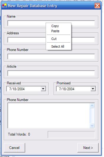

0 Steven Posted July 19, 2004 Share Posted July 19, 2004 (edited) There is a method called ".SelectAll()". Create a Menu. Call it "Select All". Add a Shortcut Key to it CTRL+A from the properites pane. Code the menu. Private Sub SelectAllToolStripMenuItem_Click(ByVal sender As System.Object, ByVal e As System.EventArgs) Handles SelectAllToolStripMenuItem.Click TextBox1.SelectAll() End Sub The above code will execute when the "Select All" menu is selected or when the user presses CTRL+A. The outcome of this code will select all the text in the textbox in the picture. :) Edited July 19, 2004 by xStainDx Link to comment Share on other sites More sharing options...

0 JadeWolf324 Posted July 19, 2004 Author Share Posted July 19, 2004 what about if i have multiple fields...how do i make it know which to do it to? Link to comment Share on other sites More sharing options...

0 DrZoidberg Posted July 19, 2004 Share Posted July 19, 2004 For capitalization, look at the "CharacterCasing" property of the WinForms text box control. You can set it from within the Windows Forms designer. The "ActiveControl" property of the "Form" class will tell you what the active control (if any) is on a form. It's a fairly trivial matter to check whether this is a text box and if so, to select the contents of that text box. Link to comment Share on other sites More sharing options...
