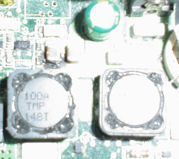

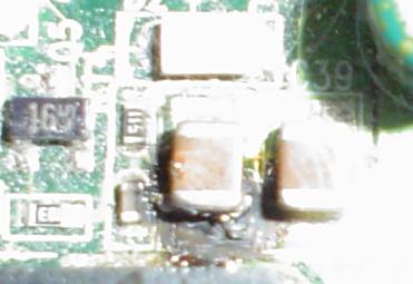

Here's a pic of a resistor that fried after i fiddled with the power supply and it stopped blinking (it went back to a constant glow). 3 seconds later (i didnt turn on the power) and smoke was coming off of this part... Wish me luck on repairs guys!

is that inside the power supply on ur power cable or inside ur laptop? again a zoomed out photo so we could catch our bareings would be helpful.
Unfortually looking at that.... i'm guessing if its the power board in the laptop then its probabily toast.... i wud recon its repairable as long as its not part of the mainboard or hasnt fried anything on the mainboard
see that green thing with a silver top... top of the pic.... there capacitors.... do u see any of them that look like there buldgeing or leaking anything... there tops should be perfectly flat?
maybe a pic of the enitre mainboard would help as that one still doesnt really give us much.... we have 2 detailed now so 1 of the entire mainboard

Here is an image of the mainboard. None of the capacitors seem to be leaking or damaged at all... the only visible damage is the bit of charred circuit on that resistor (thats what I was told it was from a techie ((non-HP techie)).

Apart from that 1 part of the mainboard everything looks normal although looks can be decieving.....
I think your best option is to find some clever little electrician and see if they can replace some of the parts.... not an any thing to with the size of em so it may be a little pricy
