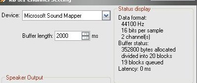

KB 5.1 Channel v1.00:
http://kb.lysium.net/my/downloads/KB51Chn.exe
KB 5.1 Channel (some other version).
http://download.nullsoft.com/customize/com...nels_Output.exe
Try both!!, they're actualy the same, only v1.00 includes volume control.
Amd what is this stuff? :whistle:

The plugins to get 5.1 in winamp.

yea i done it before..but maybe it's becauze i got realet a3.61drivers so now i`m downloading 3.63..but u know i saw before that in direct sound output it shows 5.1 speakers but it doesn't work...while in other output which calls wave output shows that there's 2 speakers..:(
i tried them too before..but in old songs it sounds like double-speed or smth..and yea it's like all speakers work...but sound isn't like 5.1
