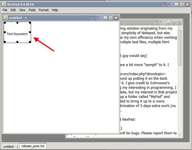

Ok, I have a slight issue and for some reason I am not able to resolve it. I have a parent form with a drag and drop event to open files dragged from explorer into a new child form, it works fine. I also have children forms with a rich text box (txtMain) filling the entire form. I took the very same code from the main form and just put it into the drag and drop events for txtMain. It works as well, the new child form is opened and its txtMain is filled with the information from the text file. It works fine, with one exception, it leaves a boxed link with the text "Text File" in the txtMain into which the file was originally dragged. How can I prevent it from doing this while still doing every thing else?
This problem only happens in 2.0 and not 1.1. I'm guessing the rich text box control was altered a bit.

thats actually a known bug.. I can recall reading about it on the Visual Studio Express blog site. they have no fix for it and they say it has to do with previous version of the 2.0 framework being installed. They said there is no resolve for it but they do know its there. Also can you post a pic of the mess

Due to the crappy documentation, I'm not able to find a definitive answer, but I saw that you posted on the newsgroup.
I suspect that the CreateRichEditOleCallback has something to do with it always linking/embedding the file into the control. If you create your own custom RichEdit contro(via inheritance)l and override that method, you'll have to create your own drag-n-drop code as all d-n-d events won't be raised(according to what little docs there are).

There might be a work around. It may involve SendMessage. :)
If you look at wordpad, which uses the RichText control, you'll see the same behavior. It could be that this control isn't near being finished. I would think that MS will provide a way to cancel an OLE event if you handle the DragDrop event.
