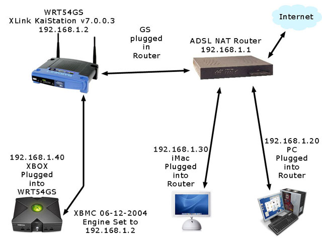

I am trying to add a wireless router to my network. I have attached an image of how it looks.
I can access the internet from all the attached hardware. Except from within the Linksys router. I can ping all the IP's on my LAN from it but not the internet. Have I connected it wrong, any help is welcome.
You really need an access point, not another router.
Can the WRT54GS act as an access point only? That would INSTANTLY solve your problem.
Otherwise, you need to make sure that the default gateway of the WRT54G is set to 192.168.1.1, and it will fix-ish your problem. (Which is NAT over NAT)
I would suggest changing the kit if possible.
If you HAVE to keep the router and run it with NAT enabled. Make sure you DMZ 192.168.1.2 from the "ADSL NAT Router" and in turn set the WRT54GS to DMZ to 192.168.1.40. You will NOT in this configuration be able to talk from the XBOX to the other two pc's and vice-versa.
