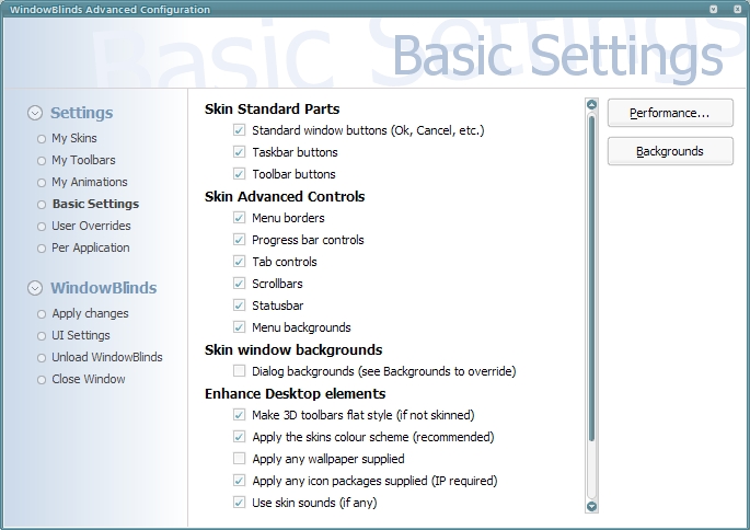

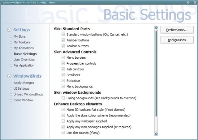

Well I'll be damned...
Just when I was about to re-install the whole XP
I checked the C:\Program Files\Stardock\Object Desktop\WindowBlinds
and clicked wbconfig.exe...and voila! WB works perfect. :blink:
Now, I still don't understand the 'why'of it.
WB option still doesn't appear in display propeties--> appearence tab,
and I haven't checked yet if the skin stays when I reboot XP (I'm in the middle of a delicate download you see), but this is great!!!! :woot:
@eRad: maybe you should try this too, because I had the same symptoms as you and this worked for me as you see.
