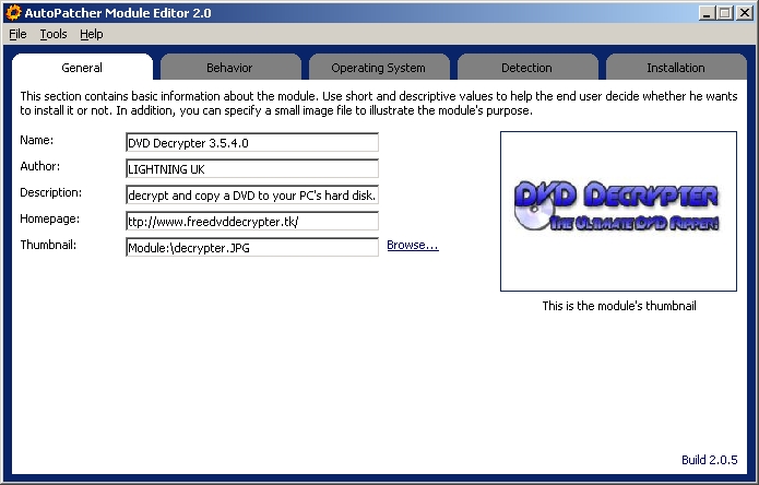

I'm trying to create a module for DVD Decrypter (something to start with and gain knowledge), and this is what I have so far.

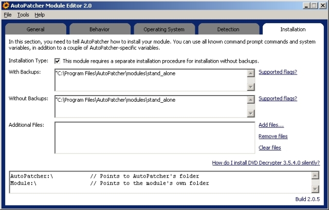

now, you cant use C:\Program Files\... as the installation path because not everyone installs autopatcher to that location, and what about people running autopatcher from a CD???
instead, you can use the special autopatcher command 'Module:\'.
when you install a module with autopatcher, autopatcher will workout the path to the modules folder and put it in place of the command.
e.g. to install setup.exe, you would put "Module:\setup.exe"
to install \testfolder\setup.exe, you would put "Module:\testfolder\setup.exe"
note, sometimes modules for multiple versions of windows and lanuages use the same setup file. if your making such a folder, it does not need the same name as the one module.
to point to the setup file, instead use the "AutoPatcher:\" command which points to the folder containing autopatcher.exe itself. you can then point directly to the folder itself by adding subfolders.
e.g. "AutoPatcher:\modules\addons\test\setup.exe"

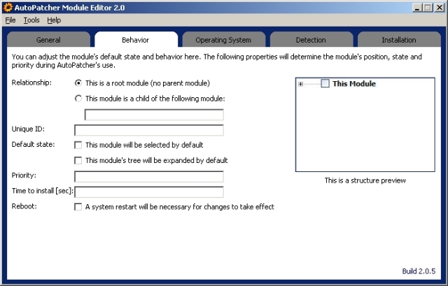

unique ID - you can actually ignore this field because we dont use it anymore, it will disappear fully in AP6.
ID's are now the name of the amc file itself (minus the extension)
parent id - if the module is to appear under something else in autopatcher (eg the shockwave player appears under addons) you need to give the ID of the module it appears under.
priority - this is used to create an order in which to load and install modules.
usualy the date something was released is used, but it doesnt really matter for anything other than updates, as long as the value is larger than that of the parents.
it should be an 8 figure number. for dates we enter in the format YYYYMMDD.

^ okay lest say you have the following:
C:\Program Files\AutoPatcher\modules\stand_alone section\test_module.amc
C:\Program Files\AutoPatcher\modules\stand_alone section\test_module.amc_files\setup.exe
now, you CAN NOT use the above path to the setup file in the installation instructions, because not everyone will have a copy in that exact location. if autopatcher is run off a CD, the setup files will be found on disk not in C:\Program\Files... !!!
so instead you would put the following in the instructions:
"Module:\setup.exe"
now, when autopatcher comes to install your module, it does the following:
- grabs the name of the amc file (test_module.amc)
- adds "_files" to the end (test_module.amc-files) to result in the name of the folder
- it then calculates the full path to that folder which solves the problem of different locations, such as runing from a CD!
- it then uses that full path to run the setup file.
now one thing you may want to do is to add switches to the setup instructions to get it to perform a silent installation.
find out what (if) there are any silent switches, then lets pretend '/quiet' is the switch, you would put as the instrcutions:
"Module:\setup.exe" /quite

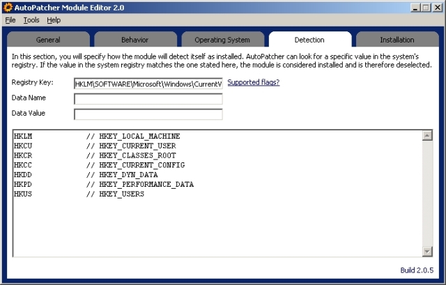

the amc file is looking good, you only need to finish off the registry detection fields.

I guess I'm having trouble on the registry part. :(
What do I need to look for?

in your registry, go to the registry key path that you specified in the amc file, right click on the last part of the key - "DVD Decrypter", select export and save the file.
then attach the file to an email and send it to me at theblazingangel 'at' aol.com (replace 'at' with @)
ill then have a look for something to use, if not ill just install the software myself here and have a deeper look.
586669020[/snapback]
Repack it again with the .exe in it & the registry file. Hopefully it is correct this time. I thank you for your help. It is my first time doing this.
Sent you an email to your account, and the updated file is also on the link I sent you yesterday.
