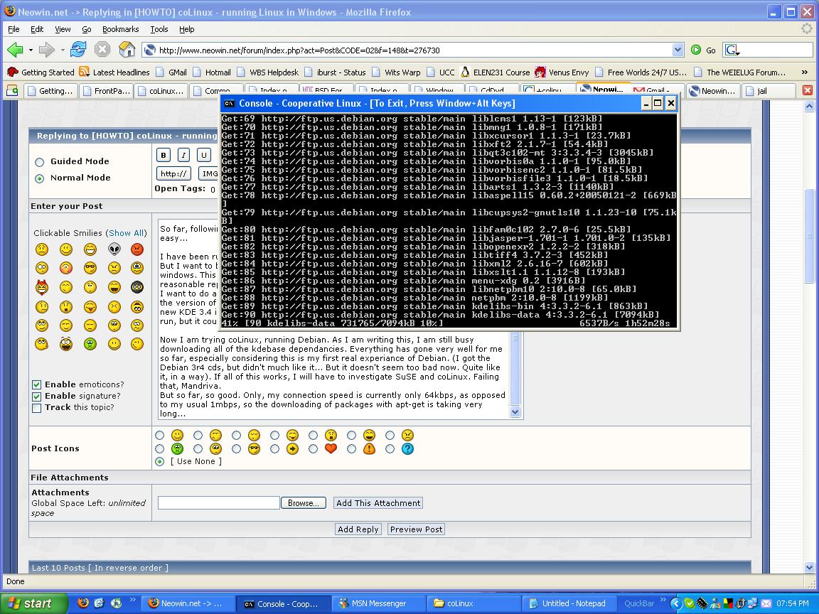

Now I am trying coLinux, running Debian. As I am writing this, I am still busy downloading all of the kdebase dependancies. Everything has gone very well for me so far, especially considering this is my first real experiance of Debian. (I got the Debian 3r4 cds, but didn't much like it... But it doesn't seem too bad now. Quite like it, in a way). If all of this works, I will have to investigate SuSE and coLinux. Failing that, Mandriva.
But so far, so good. Only, my connection speed is currently only 64kbps, as opposed to my usual 1mbps, so the downloading of packages with apt-get is taking very long...
I dont have anywhere to host the screenshot, so i cannot post it here...
and its only a single console window, busy with an apt-get install of kdebase. Not much to see... it might be more impressive if i have a shot of the logon prompt, where you get dumped after a fresh Debian install (coLinux or otherwise)
I found a place to stick my screenshot.. a little attachment box.

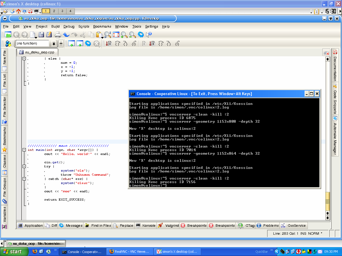

I also now have a minimal KDE system running, with the display exported through a VNC server. So, using RealVNC Client in windows, I can connect to 192.168.0.40:1 as my graphical display.
This configuration (coLinux + VNC) seems to operate a lot better than Cygwin/X, and also seems to use fewer resources.
After many hours of waiting for KDevelop3 and its dependencies to download, here is the final result.
A vncserver running in coLinux, exporting a display resolution 1152x808 (My windows Res is 1152x864) This resolution makes the windows taskbar still visible below the VNC Viewer window, but also maximizes the size of the KDE desktop (I maximize the VNC Viewer Window, and with any larger vncserver geometry, i have scroll bars.) The nice thing about runnning the slightly lowered resolution (1152x808) is that i still have full, easy access to my windows taskbar, and anything i need to do in there. I can run a full screen Viewer window, with the vncserver -geometry set to 1152x768, but that makes a little more difficult to switch between KDE and Windows.
Oh, I had to manually fix a couple of dependecies (for building C++ projects with kdevelop). apt-get install libtool; apt-get install g++
without libtool, i got some problems trying to run automake and autoconf etc. got libtool, then in configure, I got told that my c++ compiler could not create executable files. After a quick Google, I found that I should check if g++ was installed correctly (or at all). It was not, so i got it, which fixed everything.
