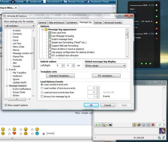

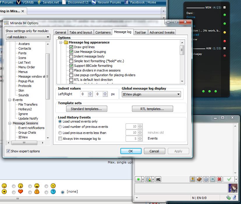

Decided to switch back to Miranda last night, and installed IEView. [And TabSRMM, of course. Newest builds.]
The thing is, I can't get IEView templates to show up. I've tried everything and the message windows still show the same default theme.
I keep seeing posts in help topics that say something like "Make sure you go to Message Sessions>Message Log and enable 'Activate support for external log'." or something similar, but there's no such option. :/ Any ideas on what's going on?
