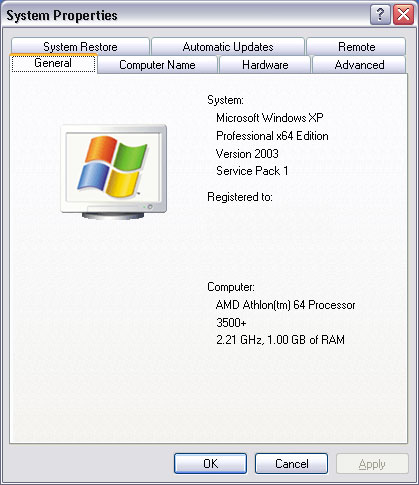

Well, as you can see by the screenshot, I finally got around tonight to installing xp64! :D :punk: :punk:
So far so good, although I am in the first stages of everything, all of the drivers I did find* installed without a hitch, and no noticeable problems with anything at all.
My boot up time is unbelievably fast. I know there is nothing on the system yet really, but it is still dramatically faster than a fresh install of normal 32 bit based XP.
* I was very happy to find the Creative 64 Beta Drivers, and they worked like a charm. I love the Creative Audio HG Control Panel interface so, so much more for xp64 than I do for normal XP 2. It is super streamlined and not bloated like the normal one is. The sound was excellent.
I also ran Doom 3 from my already established Game Drive, and although I saw Circaflex's link to anandtech reporting a dramatic decrease in games, Doom 3 ran absolutely FLAWLESS, just as good as it always does, and I think unless it was my imagination, actually slightly better. I am going to run the Doom 3 timedemo one of these days soon to see exactly what the performance is under xp64, but I can say just from using the com_showfps console command, I definitely am not losing any frames per second at all.
Just trying xp64 is going to be a very slow, slow process, but as I said, all is good so far, and I will probably one to teo days a week boot into xp64 to see how certain things perform over time.
