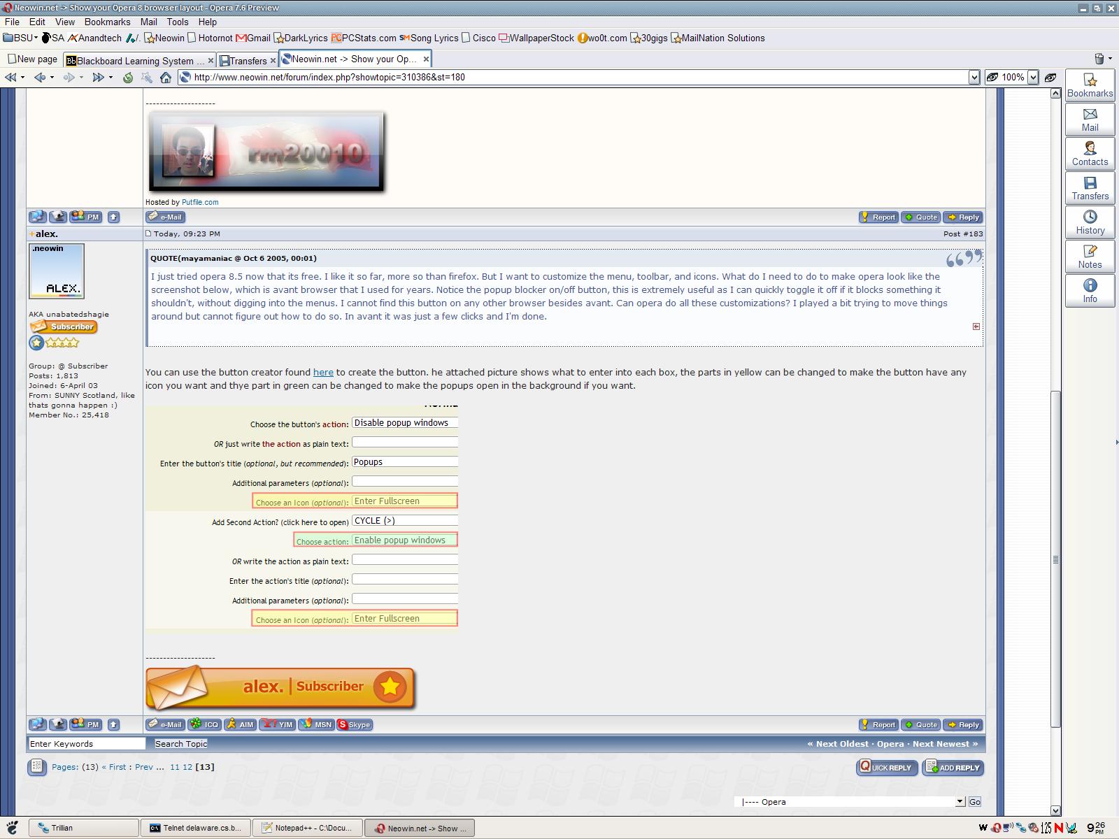

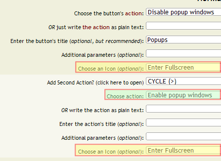

You can use the button creator found here to create the button. he attached picture shows what to enter into each box, the parts in yellow can be changed to make the button have any icon you want and thye part in green can be changed to make the popups open in the background if you want.
Again, was hoping for simpler solution, I mean now I have to make a PopUp Blocker icon. Will explore more when I have time to read through it.
