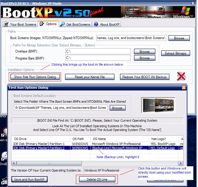

bfoos Posted May 14, 2005 Share Posted May 14, 2005 nevermind (sorry for double post but I can't find delete post button). Anyone know of a good way to change the boot screen without having to use style XP or the logonuibootrandomizer (I would use this but that two OS thing was annoying me) 585916477[/snapback] I suggest giving bootxp a try. It makes a backup of your boot.ini and doesn't overwrite your ntoskrnl.exe file. You will initialy have 2 choices on boot (one is the modified boot screen and the other is a failsafe backup line). If you delete the backup line, you won't be prompted by the boot loader it will just use your modified boot screen and boot windows. Here is a screenie with instructions on how to remove the backup os line in bootxp. Link to comment Share on other sites More sharing options...

bfoos Posted May 14, 2005 Share Posted May 14, 2005 [boot loader] timeout=30 default= [operating systems] multi(0)disk(0)rdisk(0)partition(1)\WINDOWS="Microsoft Windows XP Professional (Original)" /fastdetect /NoExecute=OptIn /KERNEL=LOGOOS.EXE 585919658[/snapback] Ok, if you copy and paste the boot.ini contents I posted above it will return your boot loader to default. Now when you run bootxp it will show you your boot.ini and ask you to save it. You can now use the program to change your boot screen. As for the messed up colors and progress bar, I'm not really sure. I've only had one boot screen that had an out of place progress bar and I just exracted the the background with resource hacker and moved the bars container with Paint. If you find a screen that works, you can use the intructions in the screen I posted above to get rid of the backup line and remove the OS choice at boot up. Link to comment Share on other sites More sharing options...
