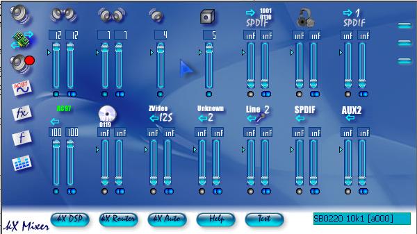

Once done with that, you will be taken to the main Kx mixer. Here you can enable 5.1 audio, change the volume levels for each individual speaker, the bass levels, recording levels, enable Surround audio (Low, Medium, High settings) and many other things
At this screen you have a variety of settings. These are all very dependant on how you have your speakers placed, the type of music you listen to, and your personal taste in how your music sounds. I like my music to have a balance between good, bumpin, bass and a surround sound effect. Heres how Ive set up mine for this.

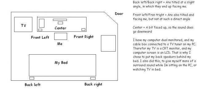

As I said before, its all dependant on where and how youve set up your speakers. Also, on how many you have as well. Take note these drivers take anything from SB Live! to Audigy2 and above, so the combination of speakers can be 4.1 - 7.1. Heres how Ive setup the speakers in my room, just to give you an idea of why Ive setup my speaker volumes the way I did.
Another note I should add in to how Ive setup my speaker settings in the drivers is this...In the first screen of the Kx mixer I have my Master Mixer at 100% and the Wave at about 15%. I do this because if I go too high with the wave, I get alot of distortion with music and games. Also in this same screen, I have the "Toggle front Swap and read mode" option checked, which should be done by default when you install these drivers. Along with that, in the back of my SB Live! instead of pluging the green into the green colored part on my computer, I switch them up. I put the black into the green, and green into the black. This adds better sound for me, but like I said before, its all dependant on taste. In the same screen where Ive mentioned these settings, you can enable 2.1, 4.1, or 5.1 audio. To access this setting, you can also just right click the Kx project icon on the taskbar and go to Add-Ons>Surround + [8]. Here you can do alot of things. My setup in that specific area is 5.1, for Surround I have copy, and I check off Subwoofer Output as well as Bass redirection. The bottom part I put all the way up to 320hz and voila.
Also, one added thing. Open Kx mixer and go to the icon where it says AC 97, in this screen go to the 3DSE area. Here you can choose Low, Normal or High levels of 3DSE. This all depends on your taste as well as your speakers. Some speakers might sound a bit awful when put in high, so normal should fit most users. I have mine set to normal, and I get good bass and speaker output. I listen to a variety of music, alot of which is spanish, but also I listen to old school punk and things of the sort. But were all different, so as I continue to repeat, configure them to YOUR taste. Put on Winamp, and let your favorite song play, during the playtime edit your speakers to how you like them.
