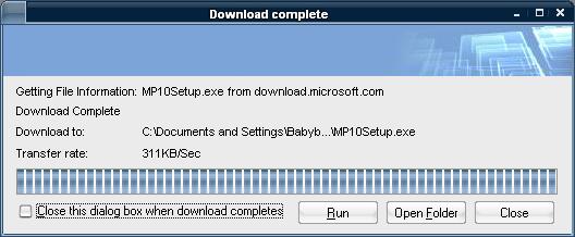

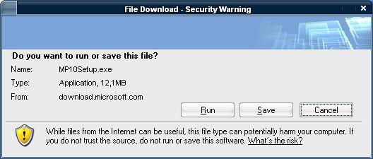

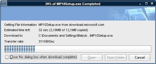

change the download window in IE6 and IE7
Hi here i explain how to change the download window in IE6 and IE7
Download this to your hd

11. Goto Dialog => 4416
12. Replace with this and compile Script

Prev.
Download window
Downloading
Download finish

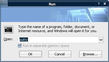

*edit btw what do you think of the run box?

And i can't chance the run box in to somting else becose where i'm gone set the text? i can set it in the bitmap becose backgrond of the text is gray :wacko:
and dident find it yet to chance the collors :s
586329923[/snapback]
Its look nice.. :D
that's great. i think the size is perfect.

About the run and the other dialog boxes, if we have the modded shell32 from the Vista Customization Pack, how will we be able to modify it? Can you post a tutorial too as oppossed to just a modded shell32? it will be greatly appreciated.
thanks in advance,
