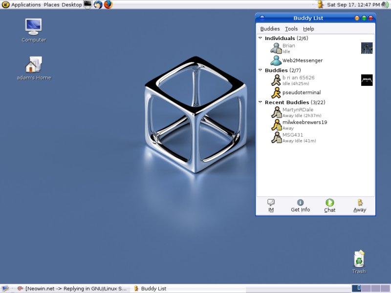

Clearlooks Cairo and Dropline Nuovo Icons exported to png and shadowed w/ the gimp....much nicer
