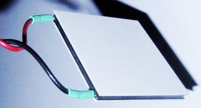

Well here it is. Right next to me, nearing the end of May, I have frost:
Seeming you're in the overclocking forum, you probably already know what this is. But for those who don't know, it's a peltier also known as a TEC (thermo electric cooler). What happens is you pass current through it, thus causing heat to transfer from one side to the other, making one side freakishly cold and the other side freakishly hot.
I've had this 170W peltier for almost a year now and the coldest I've been able to get the "cold side" has been about 10-20C (not very impressive) so all I've gotten has been a lot of due forming
But this summer I was determined to have another go. I had failed before because a) my power supply I used to power it simply wasn't powerful enough and more importantly b) I was not able to keep the hot side from getting too hot.
This is without a doubt the toughest part of dealing with peltiers (I reckon), with powering and condensation coming in 2nd and 3rd. Peltiers try and create a temperature difference between the two plates. My one can have a maximum theoretical temperature difference of 69C. This means if the hot side of the plate is at 100C, the lowest the cold side of the plate can be is 31C. If you can keep the hot side of the plate below 69C then the cold side of the plate can go into sub-zero temperatures.
Now trust me, these peliters produce a lot of heat. This one on it's own produces up to 170W of heat. Your typical prcoessor produces about 100W and we all know how hot those get. So last year I had naively thoguht I could use my old 3000+ heatsink to keep the hot side cool.
I was wrong.
The heatsink rapidly got incredibly hot (too hot to touch) and the cold side ended up being mildly warm!
This time I was going to make no mistakes...Well I did, but not as many as last year.
I researched into heatsinks and found a lovely little ?17 heatsink and fan called thearctic freezer pro 64>. I know that there are better heatsinks out there, but this one specifically said it could dissipitate up to 250W of heat. So for a peltier, which on it's own produces up to 170W of heat, this was perfect. And was mostly right.
Mostly
Turns out that while my peltier is 50x50mm , the base of the heatsink was only 40x40mm. Argh! This would not do. Peltiers do not conduct especially well (i think) so any part of the hot side not in contact with the heatsink gets very hot and will not allow heat to flow to other parts of the peltier which are in contact with the heatsink. This is what I mean:
So, pretty simple solution to the problem actually. Just plop on a piece of copper 50x50mm in between the peltier and heatsink. As copper is a FANTASTIC conductor of heat (almost twice as good as aluminium) I hoped that it'd be able to transfer heat from the "bare" ends of the peltier to the part of the peltier where heat was being taken away by the heatsink. And this is what I got:
And so now, my little peltier which I got a year ago is now producing sub zero temperatures:DD
Here's a bit more frostage:

Don't worry, they aren't noobish questions at all, all very valid.
The little setup I photographed was a testing step to see whether I could get this peltier to get down to sub-zero temperatures at all. The rubber bands are just there to stop the rather top-heavy heatsink sliding off during this testing phase :p
When you put it into your computer it's an entirely different ball game. As mentioned before the peltier uses up 170W of power and thus gives off 170W of heat on the hot side. The heatsink/fan is designed to dissipitate up to 250W of heat so can happily take care of this heat.
However if you put the peltier on top of the processor, you've got the heat from the processor being "sucked" up the peltier into the heatsink as well as the heat the peltier produces on it's own. A processor can give off about 100w of heat. Which means 100w of heat is going from the prcessor into the peltier. The peltier pumps out that 100w of heat into the heatsink as well as the peltier's own heat (170w)
So 270W of heat going into the heatsink. The heatsink can only dissipitate 250W. There's a problem. This is the reason why you rarely see anyone use air cooling to cool their peliter in their computer. Air cooling just isn't efficient enough! Which is why if you ever pop a peltier into your computer the hot side of the peltier has to be cooled with something more efficient like a watercooling setup which can quickly take the heat away outside the case and into large radiators which can dissipitate MUCH larger amounts of heat.
There are other problems as well such as condensation forming around the peltier and thus water forming on the motherboard. So craploads of foam and insulating grease is used to prevent the water from basically destroying your computer :p
So basically I'm not planning on putting it directly onto my motherboard. At least not yet. The watercooling setup I have is a VERY noobish, cheap, premade one which isn't much more efficient than the heatsink I used. So I'm more likely to use the heatsink+peltier to cool the water itself in my watercooler. If the water in the watercooler is cooler then the processor gets cooler :)
I'm taking this slowly as I don't have much of an income so I can only buy parts in 6month / 12 month intervals :p. This'll do for know ^^,

The 170W peltier I got second hand off ebay for ?9.50 inc. delivery (a real bargain). I used an old 400w power supply I had and the "Arctic Freezer 64 Pro" heatsink set me back ?17

After my recent successes, things seeming to be going downhill a wee bit :p
My initial plan was to first get my peltier to work properly and then see if I could use the peltier to cool the water in my watercooling setup down (10-20C)
However I had forgotten one very important thing about water: It doesn't like changing temperature!!
The reason why watercooling works so well is that it can take a LOT of heat energy and it's temperature doesn't change much at all. It takes 4,180 joules to change the temperature of 1 litre of water by just 1 degree C while it only takes 385J for copper and 900J for aluminium to cause the same temperature change. So when the water passes over the processor it takes up a lot of the processor's heat energy, while the water doesn't raise in temperature very much.
However this works both ways: it takes a lot of energy to raise the temperature....the same way it takes a lot of energy to lower the temperature.
So when I decided to connect the cold side of my peltier to the cpu block of my water cooler (no processor or anything, only the peltier) in the hope of lowering the temperature of my water, it took 30-60 minutes to get the 3kg of water to drop by just 7C!!!
I'm very dissapointing to say the least :(
And now I'm not entirely sure what to do
Perhaps I'm thinking about this the wrong way. Yes it takes a long time to cool all the water in my system by 7C, but that's not what matters anyway. In every second the cpu adds 100J of heat energy to the water (as it uses 100w of power). If I had a peltier in the water loop in means that every second 170J of energy is being removed from the water loop (as it can transfer 170w of heat). So what if it doesn't cause all 3kg of water to fall in temp? All I want to do is to cool the water down right before it hits the CPU.
Do you think this makes sense?
Anyway, I hope you guys are able to get something out of all this. I've always found the thermodynamic aspect of all this very interesting and have learnt a lot (and still learning) as I go. Hopefully you've been able to pick up on some of this.
And for those who are interested in getting a peltier. Yes it's a hell of a lot of work. But I've found it a hell of a lot of fun. If you do get one. don't get it thinking of what amazing effects it'll have on your processor, but get it out of curiosity of what this rather odd little piece of semiconductor can do. Peltiers ahve been around for a long time, but hasn't been used all that much, so there's plenty of room for innovation!
And in answer to brad's question on condensation: find out what the "dew point" in your area is. Once something goes below the "due point" temperature, condensation starts forming like crazy. Over here I can go down to 17C quite happily without a hint of condensation.

Circaflex is right, it's best not to try running apelt from the same powersupply as your computer. You may think that because you have a 600w powersupply, that should easily handle the 170W of a peltier, leaving 430w "free" for the rest of the computer. Unfortunately it doesn't work that way. Usually a peltier runs off a single rail, for me the 12V rail, and each rail has a maximum power rating. The 400w psu I used for the peltier can supply only 216W to the 12V rail. So with a peltier in there that only leaves 46w on the 12V rail for any other components
For cooling the water, it was just an experiment (pretty much everything I've done so far is just experimenting). My watercooling setup is just resevoir>radiator>pump>cpublock. So what I did to see how well the peltier could cool the water, was remove the cpu block from the cpu and attatch the waterblock to the cold side of the peltier. So when I turned on the watercooler and peltier, the water would pass through the cpu block, being cooled in the process. It managed to bring the temperature of all the water down by 8C.
I always knew that most people connected the peltier to their cpu and used watercooling to remove the heat from the peltier. However I don't trust my cpu to my peltier as if the peltier lost power (as it often did in one of my tests) it would cause the cpu to overheat and burnout. A risk I wasn't willing to take. So I tried to see if there was another way of utilising the cooling power of the peltier (I have it, might as well use it).
I had found that my cpu was almost always 10C hotter than the water in my resevoir. On hot days when the resevoir was warmer, the cpu reached higher temps, but always around 10C hotter than the resevoir. I figured if I could cool the water itself down, then it would also cool the cpu down (heat from the cpu transfers much faster if the temperature difference is greater). I recognise that this method would most certainly not get anywhere near sub-zero, but would be able to bring the cpu down to as low as ambient which I would be real happy with.
Not many people have tried chilling the water as opposed to using the water to cool the peltier. I wanted to see if it was possible. I may still buy a GPU waterblock and attach it to my peltier so I ahve a resevoir>radiator>pump>peltier-cooled-gpu-waterblock> cpu-heated-waterblock. If I find it doesn't work very well, I jsut use the gpu waterblock on my video card and use the peltier as a drinks cooler :p
