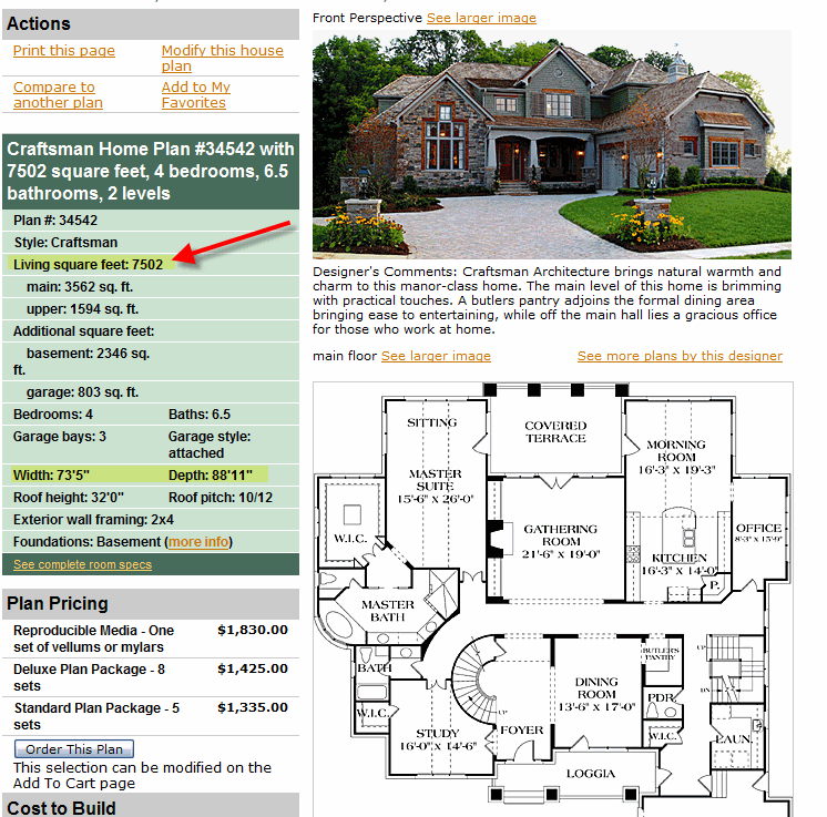

Must be something like that.. even a 7500 square foot house.. which is HUGE!! Would normally not be larger than say 120 feet in any one direction.. Most likely less than that.. here your at less than 90 feet from one side of the house to the other..
