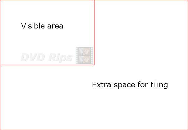

I got around the tiling issue by making the image roughly 2x larger than the visible area, so the tiling would be WAY off-screen.

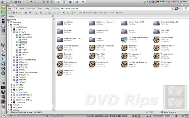

So this image:
Would display like this:
Of course, the visible area will go off-screen as you start scrolling, and the only time you'll see the "display area" again will be when scrolling thru a window with hundreds of files, like Windows\system32. If you want your image to display more often, just reduce the tiling area.
