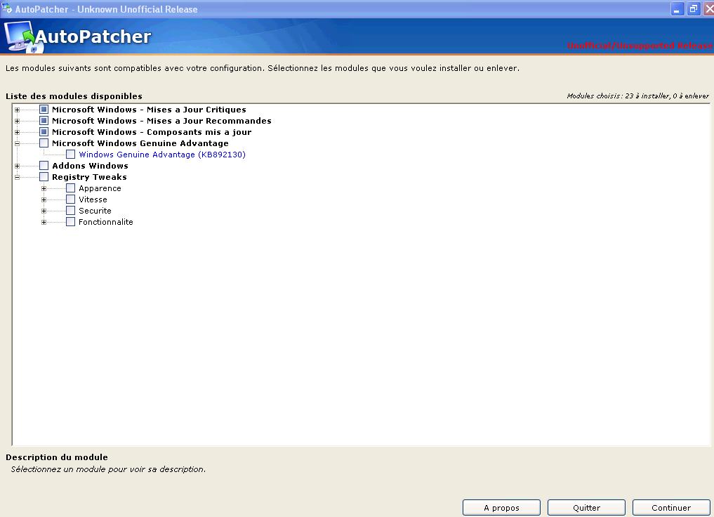

Hi guys,
Strange, it works well for me.
Do you see this screen ?
No I dont see the tree, the bug is during modules loading.
I am a bit frustated, i cant undertand how to display images inside a message in this forum... otherwise I would have show you the screen.
Maybe the upload hasn't worked. I will download the file and checked the upload.
As far as you loaded a zip and i could download and unzip it, I think the problem is not here.
Have a nice day.

Ok, I succeed to have the error.
I change my Regional options to English and I have the same error.
My regional options is Francais(France). What is yours ?
[Edit]
Gandolas is right. It's because True and False has been translated when I convert the modules by the batch of editor56.
I have forgotten the following : You have to modify something in powertoys_xp_fra.apm in the folder AddOns
UniqueID=XP_POWERTOYS_FRA instead of XP_POWERTOYS
Jean-Michel
Edited by Jean-Mich
No luck...
Francais(France) too.
Done, but I got exactly the same error...
