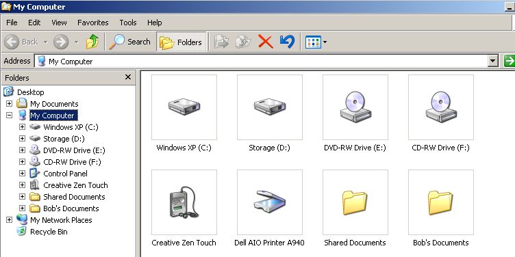

so after reading some info i downloaded the new firmware for my zen touch
but while installing it just stopt and my pc didn't recognise my player anymore
so now when it starts it starts in recovery mode and the firmware update screen said that the player was not connected.
I need to reload the firmware someway but it won't allow me to do so =[. Please help!
EDIT: attached a pic that shows that my computer sees it but the firmware update program says it isn''t connected. Isn't there some way to force the update onto this thing? I tryed coppying the firmware into the storage folder that my pc sees but it said I don't have premission to create this item. Is there any way to bios flash it or somthing though usb? Sorry about image size =[.

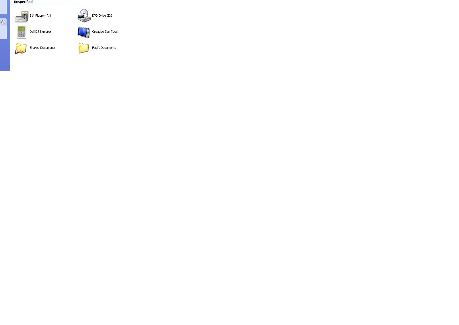

I had this problem before when I got a replacement Zen Touch 40 GB. I tried doing all of the solutions offered and emailed the joke of an attempt at Customer Service maybe 20 times with no success. Finally, they issued me ANOTHER RMA free of charge and when I tried to update the new firmware tonight I got the same exact problem.
But here's what I did and it definitely worked after a few tries (and I'm taking it from donners' post and the other to make it into exactly what I did:
- uninstalled every single piece of Creative software on my PC (WinXP) through the Add/Remove Programs Dialog (even did a search for all things named creative and deleted them)
- went to Control Panel -> System -> Hardware -> Device Manager and uninstalled the "Creative Zen Touch" from the list of hardware, while I had my player connected of course
- disconnected my player

- at this point I moved the USB cable into a USB 1.0 port on my motherboard as someone suggested this might have helped earlier in this thread. I'm not sure if it made any difference, but I would guess not. (in my case, it didn't matter which port I used).
- reconnected the player (WinXP then installed the hardware properly as an MTP Player which it hadn't done before)
So basically, for me I....
Unistalled every single trace of Creative on my computer and uninstalled the hardware.
Then I rolled back or removed any trace of Windows Media Player 11 (the runtime or oherwise) until my computer only had WMP 10.
Note: It was only until I saw that "Creative Zen Touch" had an error symbol next to it (Yellow circle and exclamation point) in the hardware manager that when I deleted it and rebooted and then reconnected the player, instead of recognizing it as both MTP AND Creative Zen Touch, it only recognized it as MTP.
So when Is aw that it ONLY recognized the hardware as a MTP device, I tried the firmware again and this tiem, it actually recognized the player! It updated in no time!
And because all my creative software was gone, I had the option of permanently synching it to WMP, which is exactly what I wanted.
I hope that helps and I know my post wasn't clear, but feel free to contact me if you want some clarification on what worked for me.
PROBLEM SOLVED! If anyone else has this problem heres the solution. (Creative lost any future buisness with me over this :no: )
How is some bug in a propriatary Windows protocol (MTP) Creatives fault? From what I can see, you are forcing Windows to re-detect the device, which is the source of the problem (UMS mode has a bug in it if a device changes any USB info while still connected as well)
