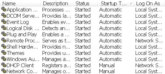

Darkon11 Posted March 31, 2008 Author Share Posted March 31, 2008 First: I'm amazed that a topic can last an entire year ! Second: In the meantime I've reduced the needed services as you can see. Link to comment https://www.neowin.net/forum/topic/538201-windows-processes-made-easy/page/2/#findComment-589303473 Share on other sites More sharing options...
APK Posted April 1, 2008 Share Posted April 1, 2008 (edited) First: I'm amazed that a topic can last an entire year !Second: In the meantime I've reduced the needed services as you can see. I take it you are trying to "shave windows down" as much as possible, AND, still have it be able to get into the OS shell... correct? You can do w/out DHCP, IF You have a router (I do it here, incidentally - I just set my router as my default gateway & OFF WE GO, no DHCP required)... You can also run without Logical Disk Manager set AUTOMATIC too (set manual). You can also run w/ out SHELL HARDWARE DETECTION set AUTOMATIC too, & turn it off later (if you went manual and it comes on anyhow). See this post (got me "modded up" @ SLASHDOT): http://slashdot.org/comments.pl?sid=157321&cid=13190570 It outlines how "low you can go" actually... & even lower IF you have a router (see my note on DHCP above). In actuality, I am fairly SURE you can leave ONLY Plug & Play & RPC running... & STILL get into Windows (but, question is, HOW MUCH CAN YOU DO AT THAT POINT, lol!) :) Also, if you REALLY want to get "crazy" & run windows, WITHOUT SERVICES @ ALL (& I have done it, quite by accident)? Alter the logon entities of the services (their ACL's) & you can LITERALLY get into Windows OS Explorer.exe shell, BUT, you cannot DO a heck of a lot either! Sounds nuts, but, I ran into that when I was experimenting with securing services... I.E.-> I ran with NO SERVICES @ ALL, because I set them to a user that was either inactive (as the user the service logs on under in services.msc) OR, I made it so it logged on as my GUEST account (which is disabled)... it's been SO long, but I KNOW it is 'doable' & you can STILL get into Windows. (IF ANY OF YOU ARE CRAZY ENOUGH TO TRY THIS LATTER ONE - be sure you have a backup of your system! F8 "Last Known Good Configuration" OR "Safe Mode" may help you out of it also, if it goes "nuts" on you!) APK P.S.=> I think a former co-worker of mine, Dr. Mark Russinovich, has ANOTHER way to do this, but... the specifics of HIS method eludes me now, but he also has discovered a way to run Windows, WITHOUT any services also... but, iirc, he too ran into what I did (limited functionality)... apk Edited April 1, 2008 by APK Link to comment https://www.neowin.net/forum/topic/538201-windows-processes-made-easy/page/2/#findComment-589306946 Share on other sites More sharing options...

Darkon11 Posted April 5, 2008 Author Share Posted April 5, 2008 I take it you are trying to "shave windows down" as much as possible, AND, still have it be able to get into the OS shell... correct? You can do w/out DHCP, IF You have a router (I do it here, incidentally - I just set my router as my default gateway & OFF WE GO, no DHCP required)... You can also run without Logical Disk Manager set AUTOMATIC too (set manual). You can also run w/ out SHELL HARDWARE DETECTION set AUTOMATIC too, & turn it off later (if you went manual and it comes on anyhow). See this post (got me "modded up" @ SLASHDOT): http://slashdot.org/comments.pl?sid=157321&cid=13190570 It outlines how "low you can go" actually... & even lower IF you have a router (see my note on DHCP above). In actuality, I am fairly SURE you can leave ONLY Plug & Play & RPC running... & STILL get into Windows (but, question is, HOW MUCH CAN YOU DO AT THAT POINT, lol!) :) Also, if you REALLY want to get "crazy" & run windows, WITHOUT SERVICES @ ALL (& I have done it, quite by accident)? Alter the logon entities of the services (their ACL's) & you can LITERALLY get into Windows OS Explorer.exe shell, BUT, you cannot DO a heck of a lot either! Sounds nuts, but, I ran into that when I was experimenting with securing services... I.E.-> I ran with NO SERVICES @ ALL, because I set them to a user that was either inactive (as the user the service logs on under in services.msc) OR, I made it so it logged on as my GUEST account (which is disabled)... it's been SO long, but I KNOW it is 'doable' & you can STILL get into Windows. (IF ANY OF YOU ARE CRAZY ENOUGH TO TRY THIS LATTER ONE - be sure you have a backup of your system! F8 "Last Known Good Configuration" OR "Safe Mode" may help you out of it also, if it goes "nuts" on you!) APK P.S.=> I think a former co-worker of mine, Dr. Mark Russinovich, has ANOTHER way to do this, but... the specifics of HIS method eludes me now, but he also has discovered a way to run Windows, WITHOUT any services also... but, iirc, he too ran into what I did (limited functionality)... apk No, I don't have a router but you can still do without DHCP setting static the IP (which I don't like). As I said in one of my first post this is not a barebone configuration and you can actually cut out something more. But I wanted a pretty functional windows W/O all the unnecessary (for me) stuff . I don't advice to go further since you could have an instable system. Regards. Link to comment https://www.neowin.net/forum/topic/538201-windows-processes-made-easy/page/2/#findComment-589315205 Share on other sites More sharing options...

APK Posted April 6, 2008 Share Posted April 6, 2008 No, I don't have a router but you can still do without DHCP setting static the IP (which I don't like). The ONLY "problem" with that, is that IF you set you address STATIC in nature, & are in fact assigned addresses dynamically/periodically (which ISP/BSP's will do, so you cannot setup a website etc. et al w/ out paying "business account" prices), is that your IP address WILL CHANGE, eventually... meaning IF for instance, you setup a website on your homebox, eventually, it would not be reachable anymore... As I said in one of my first post this is not a barebone configuration and you can actually cut out something more. But I wanted a pretty functional windows W/O all the unnecessary (for me) stuff . Agreed, & I do much the same (have for years, since around 1994 or so in fact)... from this forums? I suppose THIS: ==================================== APK "A to Z" Internet Speedup & Security Text! ==================================== https://www.neowin.net/news/main/01/11/29/a...--security-text (Posted by me101 on 29 November 2001 - 04:40 ? no comments & 795 views) ====================================> Would be evidence of that, in & of itself (dated 2001 from here when me101 posted it, but it's actual origination date was around 1997-1998 thru 2002 when it was hosted @ NTCompatible.com)... been into this "madness-N-lunacy" for a 'little while'... lol! I don't advice to go further since you could have an instable system.Regards. True, IF you push "too far", & like I said above, lol, while I was "experimenting" w/ securing services (because MacOS X had that on Windows for QUITE A WHILE in fact), I found you can get into Windows with no services alright, but, man... you can't DO much either, but, I suppose that depends on WHAT it is you intend to do with a PC that is... APK Link to comment https://www.neowin.net/forum/topic/538201-windows-processes-made-easy/page/2/#findComment-589315667 Share on other sites More sharing options...
