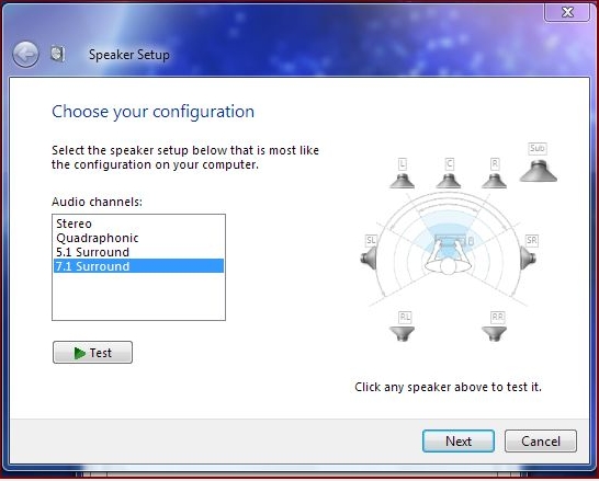

Deihmos Posted March 20, 2007 Share Posted March 20, 2007 Hey, thanks for the reply.Yeah I tried this too. Plugging the green cable into the grey port. Still no luck :( I'm thinking I might have to try an optical cable. Did you go to Sound settings in the Control Panel and changed it to 6 speakers? Link to comment https://www.neowin.net/forum/topic/547586-51-sound-problem-in-vista/#findComment-588410477 Share on other sites More sharing options...

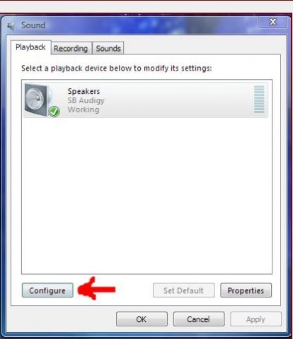

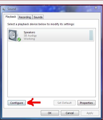

solardog Posted March 20, 2007 Share Posted March 20, 2007 How about this? Control Panel->Sound: Link to comment https://www.neowin.net/forum/topic/547586-51-sound-problem-in-vista/#findComment-588410920 Share on other sites More sharing options...

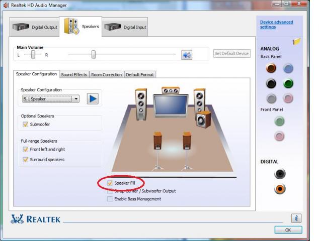

Stevieboy84 Posted March 20, 2007 Share Posted March 20, 2007 Hey guys, i don't know if this is exactly the same problem that I was having, but perhaps I can help.. I was struggling to get my rear speakers working at all in vista.. pain in the ass.. I eventually figured the problem out yesterday. I am using the Realtek HD audio on my mobo (EVGA 680i) along with Creative Inspire 6.1 speakers.. here goes: 1) Open Control Panel 2) Go to Realtek HD Audio Manager (or similar if you don't have it) 3) Tick the box saying 'Speaker Fill'... this forces stereo sound to be spread through all the speaker ports!! Screenie attatched.. Hope that helps! Link to comment https://www.neowin.net/forum/topic/547586-51-sound-problem-in-vista/#findComment-588412069 Share on other sites More sharing options...

MrBear5587 Posted March 21, 2007 Author Share Posted March 21, 2007 @Stevieboy84, Many thanks! After ticking speaker fill everythings great again :) I now have 5.1 using the 3 minijack connectors. However as it turns out, I actually purchased an optical cable to use instead to try to fix it, which has done - as there's no speaker fill option on the optical settings anyway but it's great to know that I could still get 5.1 sound in the event the cable breaks. Cheers :) Link to comment https://www.neowin.net/forum/topic/547586-51-sound-problem-in-vista/#findComment-588413105 Share on other sites More sharing options...
