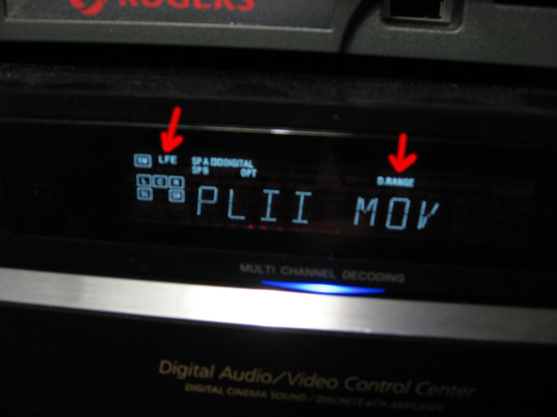

CY:G Posted March 23, 2007 Share Posted March 23, 2007 For some reason when i set my 360 to use Dolby Digital, my receiver displays some letters and the subwoofer seems to stop working and after a while it just turns itself off (subwoofer turns itself off when not being used), everything else works fine, sound comes off from each speaker as it should but there is no bass cuz the Subwoofer just doesnt do anything. If i change the settings in the 360 to use Stereo the woofer starts working again. I already tried to change the Optical Cable and nothing. The letters that are displayed in the reciever when i switch to Dolby Digital are: "D.Range" and "LFE", note that they disappear if i set 360 to stereo... Thanks in advance for any help Here is a picture i took of the receiver with those letters on (its a Sony receiver). Link to comment Share on other sites More sharing options...

Drebel Posted March 25, 2007 Share Posted March 25, 2007 did you take your receiver out of prologic II mode? EDIT: the d-range part is dynamic range compression usually called midnight mode compresses some frequencies. Try disabling that in the menus of the receiver. If I see right is that a panasonic receiver? Link to comment Share on other sites More sharing options...
CY:G Posted March 26, 2007 Author Share Posted March 26, 2007 (edited) did you take your receiver out of prologic II mode?EDIT: the d-range part is dynamic range compression usually called midnight mode compresses some frequencies. Try disabling that in the menus of the receiver. If I see right is that a panasonic receiver? Hmm, i will try to look in the manual how to disable D.Range, thanks for the help, i will give it a try once i get home. I was reading the manual after posting this and it seems you are right, the manual says something about how D.Range lets you watch movies late at night with low volumes hence no bass(it also says how to turn D.Range off), something tells me this will fix my problem, thank you, cant wait to get home :) No, its a Sony STR-DE597, same as picture below but in black... Edited March 26, 2007 by CY:G Link to comment Share on other sites More sharing options...

bangbang023 Veteran Posted March 30, 2007 Veteran Share Posted March 30, 2007 From that picture, it seems as though the receiver isn't outputting to your sub on purpose. It's only showing the five speakers. Normally, I believe it would show a sub icon too (though I haven't worked much hands on with the Sony receivers). Link to comment Share on other sites More sharing options...
