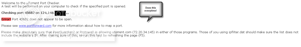

I am new to these forums but though someone here might be able to help me out as no one has replied to me on the port forward site. Basically, i can't get my port forward to work. I am trying to set it up for azureus on port 45682. I always get a timeout when i test it. I dunno why as i have created a static IP and port forwarded the correct ports.

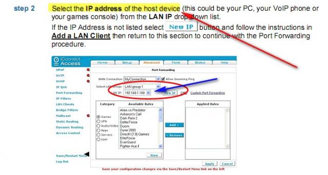

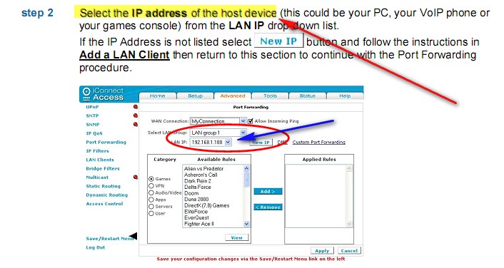

I have followed the guide on www.portforward.com countless times. I have selected my router which is the Iconnect Access 624 and followed EXACTLY what the guide has said. I have NOT left one step out! I have followed every screen shot as per the website. It does NOT work for me. I DON"T know why, but it WON'T work. Look i know how to do it but when i couldn't do it, that is when i went to that site. NO HELP. I have done this successfully before but i don't know why it has decided to not work

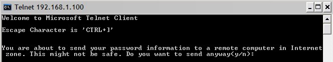

To make sure you have no firewall blocking this -- you can go to another machine on your network an telnet to your machine..
telnet 192.168.1.100
And you should get this..

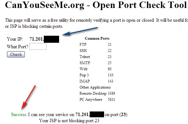

Now go to canyouseeme.org -- Verify that IP it shows you coming from is the same IP your router shows as its internet interface IP.. (blue arrow)
Test port 23
Works.. Now you can turn off telnet on your machine net stop telnet.. and it fails.

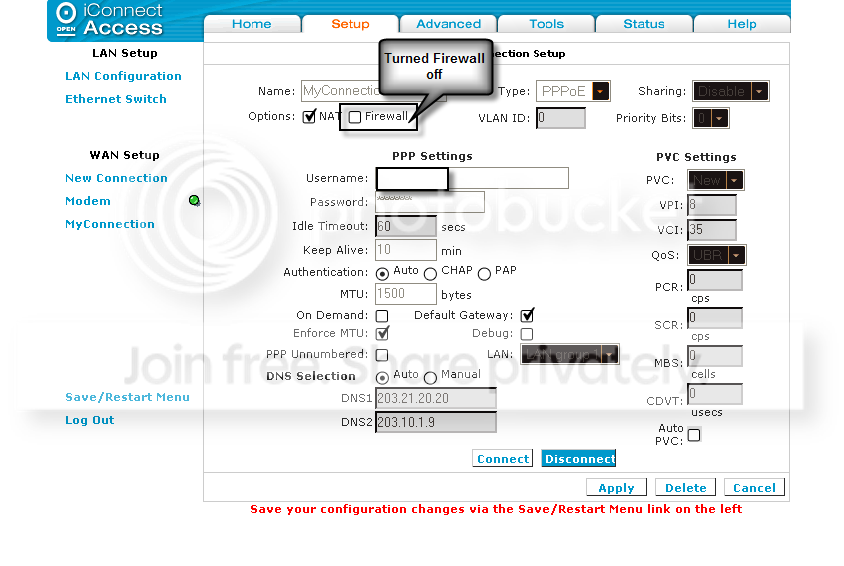

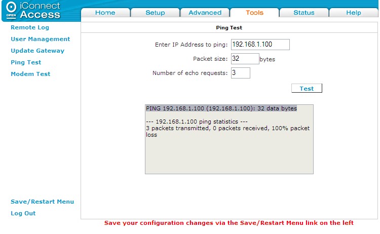

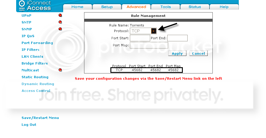

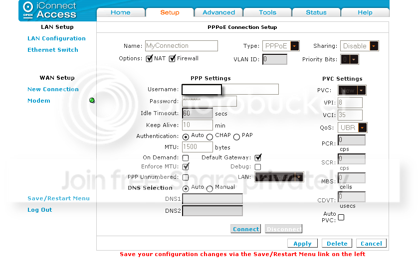

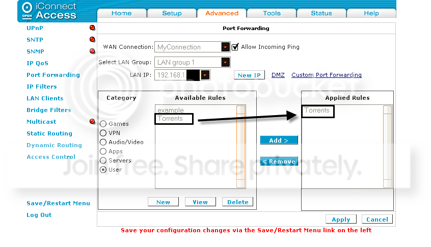

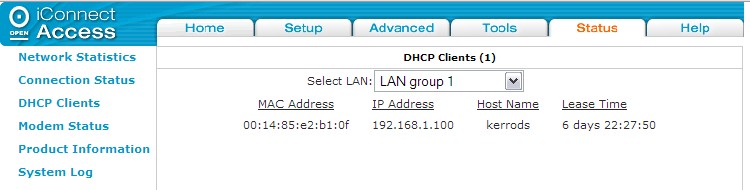

OK to answer your question, i am on XP Home not pro but do not have any firewalls on at all. I have included 12 screenshots of what i am doing to setup my portforward. May take some time to load them all.
OK here they are:

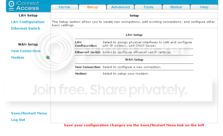

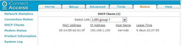

1) The 'Setup Screen'
2) Setting the New Connection
3) Firewall is now off!

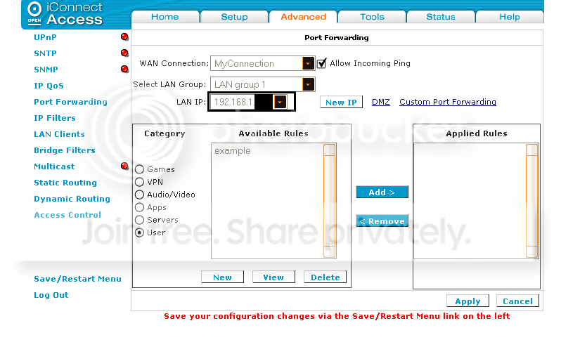

4) Port Forwarding (1)
5) Port Forwarding (2)
6) Port Forwarding (3)

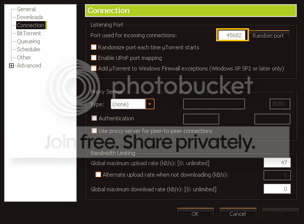

8) Setting Utorrent Port (45682)

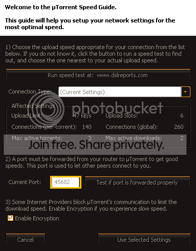

9) Testing the Utorrent Port (45682)
10) The port test fails
11) Azureus Error

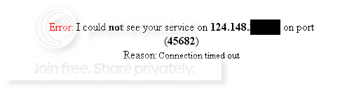

12) Canyouseeme.org Test of port '45682' fails

Well your host does not even ping from the router
So you must be running some type of firewall - default windows one? Did you turn the service OFF?
BTW -- you "REALLY" Should change the password on your router - and why an the world would you allow remote access?????
Part of the reason you should not post your FULL IP ;) :rofl:
yes that is your Router -- change the PASSWORD!!!
Well it kicked me out - so I guess changed the password! ;)
But I would assume your router should be able to ping hosts on its own lan.. since it can not, I would assume you have a firewall on. Which would explain why your forward is not working..
