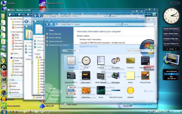

I dont understand what I'm seeing, your saying that theres some sort of bug that causes aero glass to be enabled with dual screens? (with he VistaGlazz patch)
exactly, but it won't work with just any dual screen setup. I tried to 'turn off' and than unplug the external monitor to try and get the bug to work on the external monitor but it doesn't work on that, so it must be something specific within the laptop's turn off screen thingy.

the transparency lasts as long as you leave the window alone, It won't allow me to resize the window and If I maximize it'll turn the aero off(i'm not sure about minimizing though, I'll try that later).
and no It doesn't look buggy at all, I have 1gig ram and a onboard video with ram share and it runs perfectly(even with it over video).
but I'm not sure what you're talking about in regards to the boarder size? and no I do not have access to transparency settings. but thanks for the link I'll try that out later today after I get home from work.

Yeah, I see whats happening. The resolution difference between monitors is keeping the "maximised window properties (transparent bar/border thanks to VistaGlazz)" and dimensions of the window when changing to a higher resolution screen (the notebooks) which in turn means the DWM is still able to keep the 'no aero' restriction in place but only after window manipulation by resizing the window.
I'd say to get this working properly, you'd need to get into hacking other resources that VistaGlazz isn't involved with currently...

and I measured the aero window, exactly at 640x480(the resolution of the external monitor when the laptop's monitor is turned off.
woops my bad, I opened up my mouth too soon,
with the shadow around the boarder, it's at 652x492. and without the shadow it's at 650x490

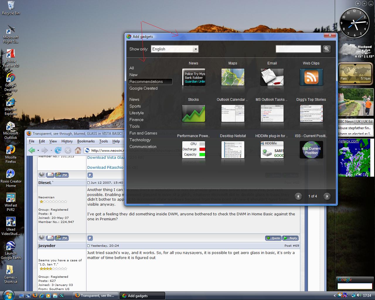

This is the google gadget menu in vista basic. Not only is it transparent in the central area but even the window frame has become transparent. So google know how to do it. Anyone here work for google? ;)
Looking at the text underneath and beyond the JPEG compression artifacts, it doesn't look very blurred, as I can actually still read the text, like the "showtopic=" part. That would be impossible if it actually was Glass at the text size and JPEG compression. Hence, Google is most likely using the traditional transparency support first introduced in Windows 2000. I also know that transparency applies to the window frame/border as well.

Still, I'd prefer clear glass to smudgy smoked blurry glass. Anyone know whether there any themes that utilise this feature that we can slap into vista basic?
Ah right. Thanks for that.
No, because basic's styles aren't much more capable than those in XP.

Here is a screen shot for all of you that still doubt Vista Basic Home can't do transparency.
All we have to do now is build a sidebar widget that maximizes and then changes the maximized size to the windows original size. We need to make this an automated process. that takes every new window and performs this trick. without you having to set it manually.
