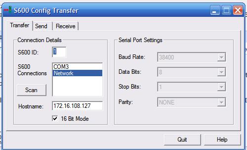

this is a screen of the software i use to flash the flow computers. the flow computers themselves are configurable, through IP addy, subet mask, gateway addy etc. when i tpyed "172.16.106.255" in the hostname, the programe just hung for a while, then said no response from the host! however, i tried pinging 127.16.106.255, and i got a response. hmmmm!
then it's a 2 way transfer, probably TCP, which means the flow computers will need to be configured explicitely to reply to your machine, not the source address in the packets
this is a big problem because that's at programming level
only one? =P
if lots of pcs were in your subnet, you would get DDoS'ed =P
it's a smurf attack, sort of =P
