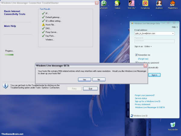

You might wanan remove the email add from the window!
Edit: C:\WINDOWS\system32\drivers\etc
Open the "hosts" file with notepad.
Remove the line relating to msn and the number e.g.
127.0.0.1 msn.com
Edit2: Probably has something to do with it being a beta version too, is it 8.5? if it is tell her to go back to an earlier version..
Her previous version was like that, so I told her to reinstall actually to 8.5
Why did you tell her to install 8.5 if its still buggy as hell?.. also Make sure to check the XP firewall settings are not blocking the connection.
Who cares what version it is?? It seems clear the software is telling you their are MSN related entries in your host file, remove them if your having issue connecting - its that freaking simple..
Shoot looks like the software even offered to remove them for you ;)
Unless "YOUR" doing something specific - there should be nothing in your host file except for the 127.0.0.1 localhost entry
An surely not anything for MSN, unless it was pointing to some beta sites??
Post up your host file if you have questions about the entries in it.
The error message point exactly to (what it believes is the) cuase of the error is. Heck it even gives you an option to clean it up.
But you can look manually by checking your HOSTS file - and only keep the localhost entry (assuming you have no need for other entries - in which case you'd already know this).

im having this same problem.. it happend after my anti virus found 2 trojans on my computer
what do these other host files do? thanks
Open the file C:\Windows\System32\drivers\etc\hosts in Wordpad.
Edit out anything besides the text below and save

NOW! i got curious as to wether just this would help, so I Tried MSN again and low and behold it worked! so hope thats another method if those others dont work for you :)
What is up with all the 1 post wonders and bringing back threads from years ago?? And now just adding gibberish??
So you reset your IE setttings, and now your issue went away -- great for you.. WTF does that to do the OP having a specific entry for MSN in their host file -- back in 2007!!! ??
  • 4 months later...
Again with this thread that was clearly closed years ago -- the error was CLEAR, entries in your host file..
The time and date had nothing to do with it back in 2007 when it was first suggested.. Now you join the forum and the first thing you do is write a nonsense reply to thread from 2007?? WTF -- and yeah I hate to bump it again.. Maybe a mod will just close it now.
