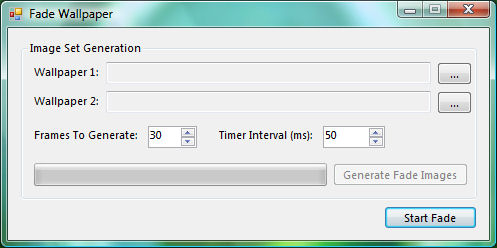

I'm working on something that may even be better, although it will only be a proof of concept... before I can improve some parts of the demo... then I'll integrate the feature into NeoPaper, a wallpaper manager I am working on.
Well, here's what I came up with so far...
Usage is simple. Choose two wallpapers, and then click the generate button. When generation is finished, click the fade button.
Screen Shot:
Known issues:
1. Generating the frames of animation for the fade effect is very slow... It would be better if it can be done realtime, but working on full screen sized images is resource intensive.
2. When fading between wallpapers, the desktop icons are hidden, if they were previously visible to start with. For users that hide their desktop icons, this wouldn't be a problem. The icons will come back after the fade transition ends, though. The problem here is that I can't find a way to tell SHELLDLL_DefView and SysListView32 to refresh and show what was painted on Progman.
3. Obvious high CPU usage because of what is being done.
If anyone has a solution to these two issues, I'd love to know. This feature will make it into my NeoPaper wallpaper manager software if I can get it done properly. :)
Download:
FadeWallpaper.zip
