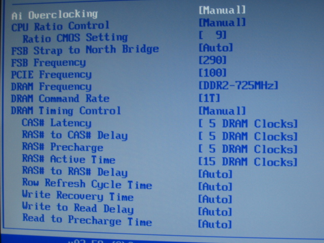

Need overclocking help for my Q6600 G0 & Asus P5K-E.

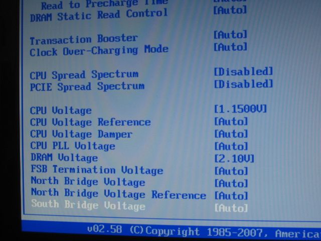

It's unstable even at these settings. I get blue screens in Windows Vista Ultimate x86. Bios screenshots to follow.
Jumpersettings configuration bios #1
Jumpersettings configuration bios #2
CPU Configuration Bios
Please suggest what I could try. Full system specs in sig.
Try the cpu voltage at 1.30 with everything else at auto, leave the ram as it is for now that should be fine, see where you get with that.
EDIT: set your ram to 1T for now, you can sort that out later once you get to a happy overclock with your cpu.

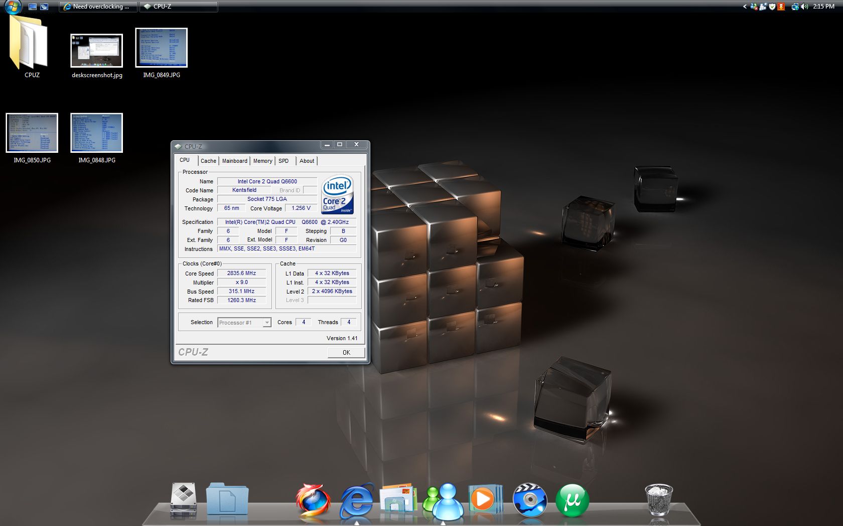

Thanks for the suggestion. I wasn't confident enough to set the CPU voltage higher than what I had it at originally.
This is my current O/C now. Anything higher gets a blue screen.

You should get a bit more from upping the cpu voltage a bit more, 1.35 shouldn't be a problem, see what you can get with 1.3 if that makes you happier, on my board aswell I have to up the FSB voltage, I have it at 1.4
If it makes you feel any better this is my limit :(
Not to make this sound even more painful for you but I was able to reach 3.01GHz (333x9) effortlessly, with your help of course

Also, do you think I could improve my RAM timings? What should I set them to?
Well, the spec for your RAM is 800Mhz 4-3-3-15 at 2.2v, you should manage 2.3v for a bit more, I doubt if will be able to run it at 1T at those timings, just give it a go, see how you get on.

I was able to hit 4-3-3-15 for my RAM with a new Vista score of 5.8

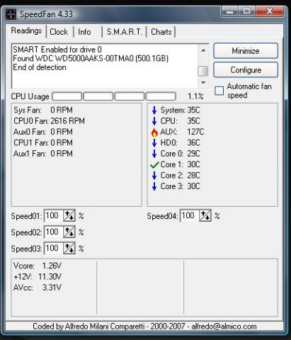

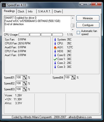

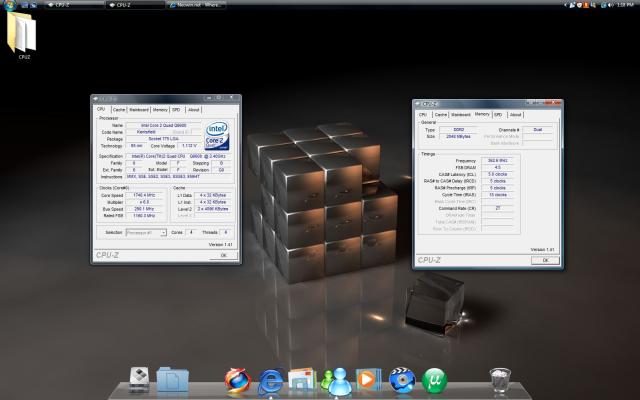

Hanif, are you running any stable tests? Also are you running Stock Cooling?
Stock cooling, yes. As for stable testing, I have ran 3DMark and had it running already for a number of days w/o any issues.

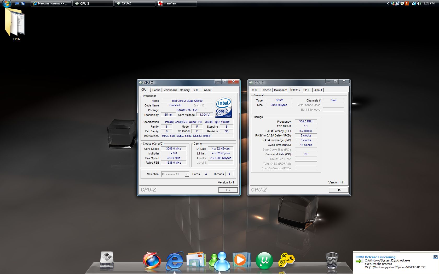

From my experience, Vista does not seem to want to overclock that high. I didn't mess with it a whole lot, though.
I'm using Vista x86 and I've overclocked my chip from 2.66GHz to 3.6GHz ;)

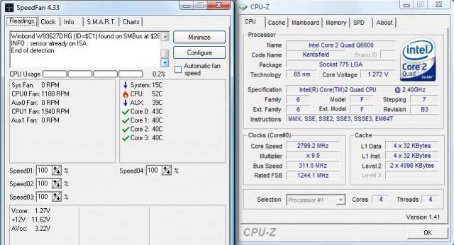

Hanif - i saw in your last screenshot that your RAM is at 2T now. I was going to suggest you change that to 2T w/ the higher overclock. also, what's your voltage set at in the bios now at 3GHz? cpu-z is only showing 1.3v in that screenshot. You could easily set it to 1.4v in the bios and still be ok. keep in mind that youre using stock cooling. youre reaching your limits w/ that cooling.
also, you board should have a bios setting called "voltage dampering" or something to that effect. I have mine turned on. it helps to minimize vdroop under load, thus increasing stability.
