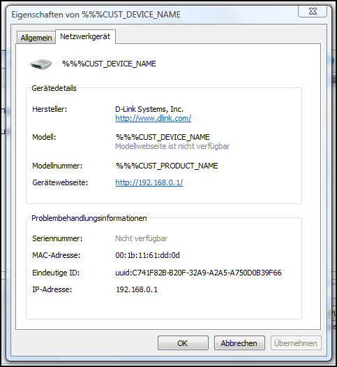

2nd Question: A screenshot of the upnp-Device properties. Is my routers firmware really that broken?!? D-Link, don't play with me, a Netgear already got kicked because of gimmickry like that... :p

As to the display of aspects of the properties?? Maybe it has something to do with your version of windows not being english??

I doubt the language dependency though. It used to work with all routers I had by now, this is the first one which doesnt. I'm on a german vista ultimate and get these results. My GF's english XP Pro spits out the same. I really doubt it though. Reported it to D-Link, let's see if they care about in in the next FW.

If its doing it on your xp with english -- then I do doubt its a lang thing, it was a guess ;)
