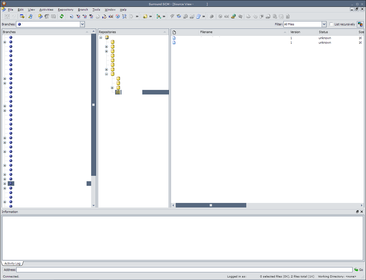

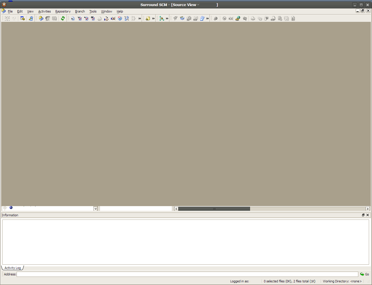

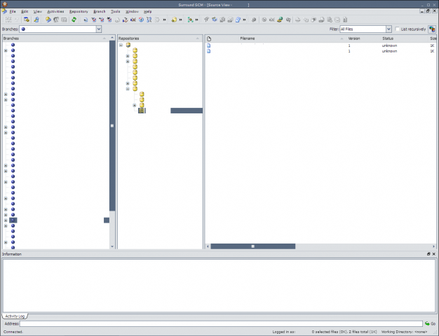

The following are images of the working theme(PxlPlus mod) and broken (Clearlooks Gummy, by WinGnomeXP). Both have had sensetive data removed, but the middle area is the part I am concerned with. In the claerlooks_gummy skin I would like to use, each column is mostly cut off.
Hopefully this helps.
Note: Typically there would be text in the PxlPlus, working mod. That had to be removed for privacy concerns I suppose...
what i'll tell you will sound very strange but it could help fixing that bug.
the problem might be implied in the SizingMargins of the Captionbar (Titlebar).
the upper screenshot shows the actual SizingMargins used by the theme.
the screenshot below shows the SizingMargins I would suggest to solve the problem.

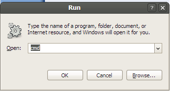

Hey Congrats man, glad you found your solution, Can I ask you to post me a screenshot of say your 'run' dialog box so I can see what effect it had on your caption buttons?
