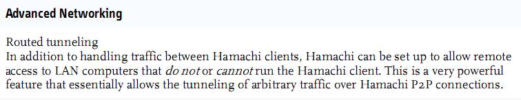

In hamachi what you need to setup is "routed tunneling"
from the manual

Here is how you could connect to any device on the work network, using 1 computer on it running hamachi. You would then connect to the NAS, just how you connect to it when your at work.
https://secure.logmein.com/products/hamachi/support.asp
How do I use LogMeIn Hamachi to connect two networks together?
Hamachi currently does not natively support bridging networks together, however, it can be made to support it. It is not recommended to do this with non-server operating systems.
Due to it's complexity in nature, and stability issues on non-server platforms, LogMeIn cannot provide setup assistance beyond these instructions.
The intent of the article is to show you how to bridge two networks of Windows computers together using a single Windows (2000, XP, or 2003) machine on each network running Hamachi with the Routed Tunneling feature.
Initial Setup
First, you need to have Hamachi set up and running on a computer on each network. Ensure the status of each computer is ?green?. Next, you?ll need to turn on Routed Tunneling on both computers.
To do this, create a file called Hamachi-override.ini in the c:\Documents and Settings\<username>\Application Data\Hamachi folder.
Inside Hamachi-override.ini add the line "RoutedTunneling 1" (no quotes) and save the file
Restart Hamachi on both computers to have this setting take effect.
