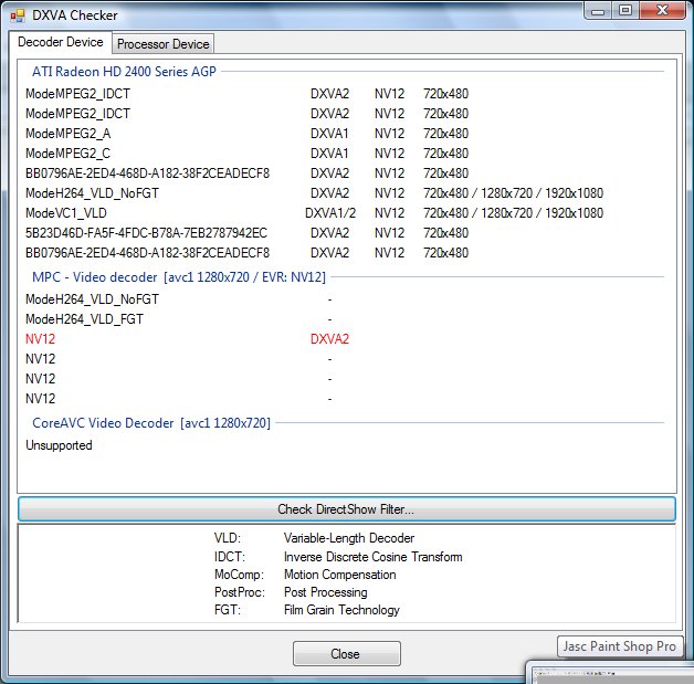

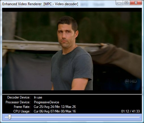

I haven't seen this mentioned yet here, but your card should support DXVA hardware acceleration which might help with your problem. Grab http://bluesky23.hp.infoseek.co.jp/DXVAChecker_1510.zip it will let you know what your video card supports exactly. Then grab a copy of MPC-HC, and extract the file MPCVideoDec.ax and register it with regsvr32, it supports hardware decoding, FFDShow and CoreAVC do not. All the video decoding is offloaded to your video card and on your system watching a 720p movie you should only see 5-7% CPU usage when watching a 720p video.
Also within DXVA Checker you can test your videos to make sure all is working:
