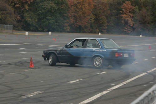

Before my hiatus from Neowin oh so many years ago. I got my hands on this E30. I had previously rolled my 85 325e (35mpg :() and my 91 sentra's rods didn't want to stay inside the block. I got into a fun motorsport called drifting. If you havent heard of it, thats ok. I have to explain it to everyone. Anywho, I now run local (legal) drift days in my area and finally took a step down to work on my car and actually drive again myself.
Heres a few action shots of it sorta recently:
