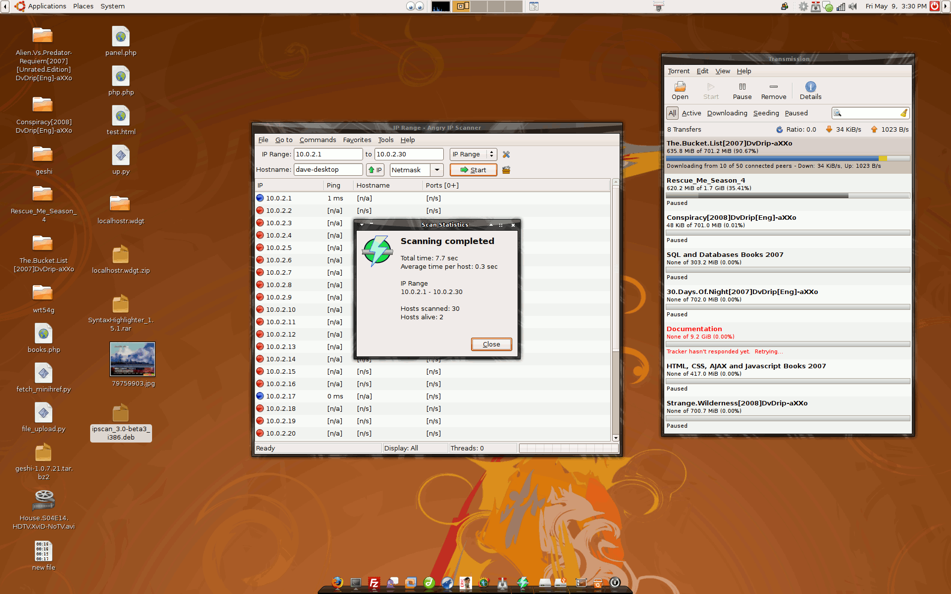

the easy way to find it when plugged in is use a program angry ip scanner
see the screen shot attached
you can see the computers which i am able to see on my local area connection
referring to the manual of the nas hard drive
there may be some sort of setup where you may need to use \\192.168.0.7 to access the drive or whatever
