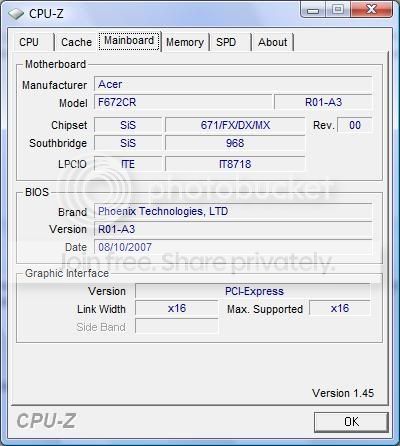

I downloaded cpu-Z and the fowlling is my mobo
@franzon: I tried that link. Acer europe is different from acer pamamerican (I live in Florida) and it doesn't have R01-A3 BIOS

http://www.acerpanam.com/synapse/data/7117.../VM261-R1B0.zip
you can access the download page for it via here
if you do have a m1610 then you have the wrong bios installed
what OS you have isn't related to your bios. completely seperate
