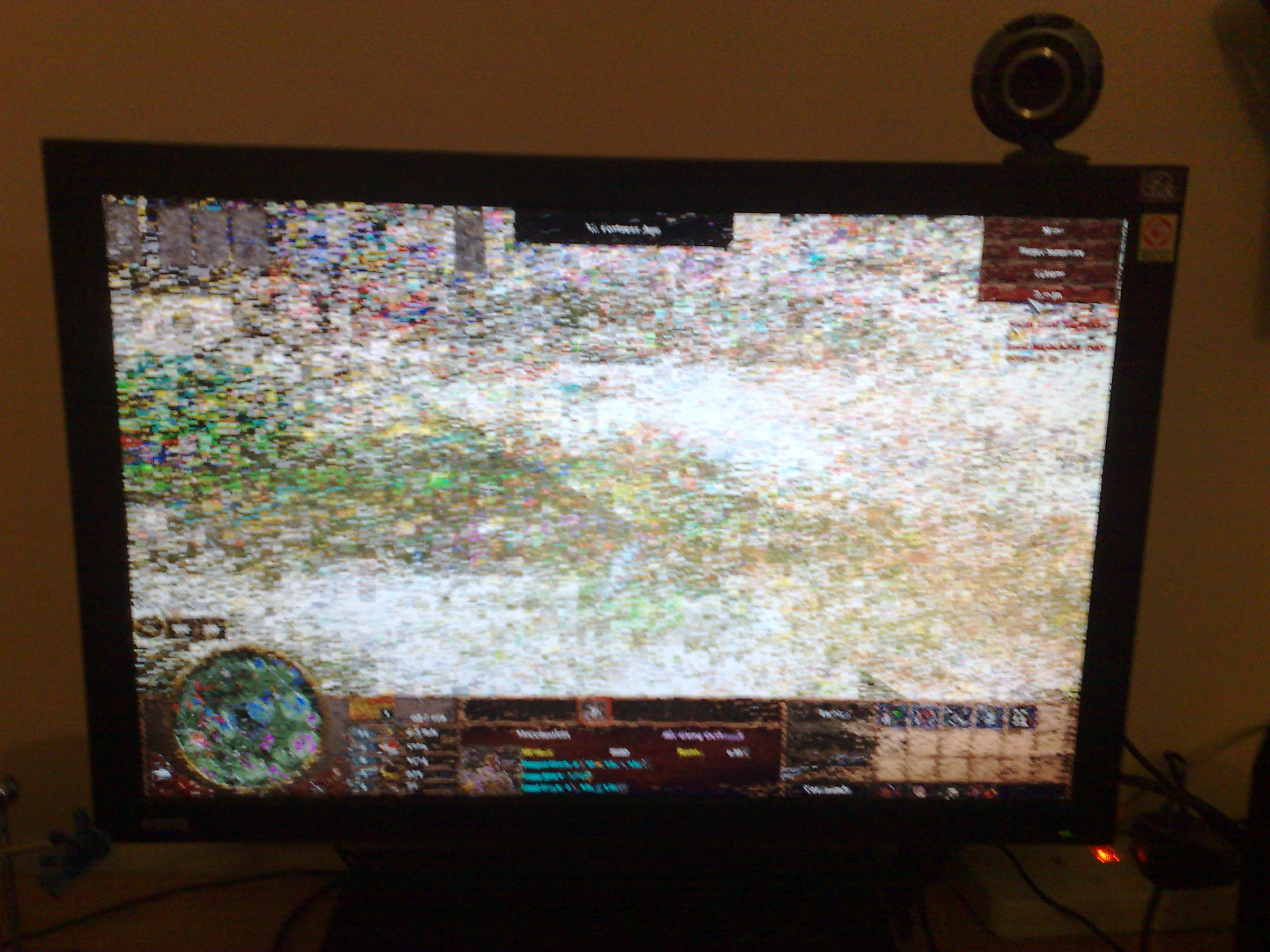

I have a rather serious issue. I just bought an upgrade - 9800GTX by BFG, Asus P5K-E WIFI/AP, Intel Q6600 and 4gb [2gbx2] of corsair ram. The powersupply is an XClio 750W PSU and I'm running Vista 64-bit with SP1
Now the problem is that when I am playing games (tried this on AOE3 and COD4) I am getting corrupted graphics every now and then. Corruptions include glitches as well as for example crates or lands coloured coloured with a red or blue tone. This has also occured when I tried to benchmark the GPU (as well as put some stress on it to see whether this happens in these two games or is common) in 3Dmark 2006 and the same happened. Another thing that occured during the benchmark was that after a few tests execute I get a DirectX error (device failed to initialize).
I have tried different drivers (BFG's own, latest from NVidia as well as the omega modified ones) but the issue is still occuring.
Anyone maybe knows what's causing this and a possible fix? I have also tried to use a different GPU (an 8600GT) but the sympthoms where different. Glitches were still occuring as well driver restarts while playing games.

well buddy, I can tell you that the issues I had have re-appeared after I formatted and installed Vista 32-bit (in hope of MAYBE solving the random driver restarts I was getting when I was running x64 vista). I am half way fearing that it is software related or maybe some hardware incompatibility....
I have searched a little bit around the internet and found some other forums with users having issues similar to mine and they were blaming SP1 (I have not run my system without SP1 since I am using a slip-streamed DVD) ...
[Edit: attached a screenie of the resulting "corruption"]
