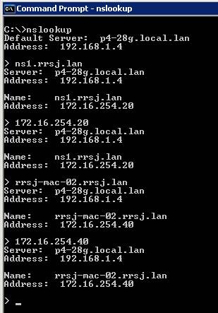

Forward resolution works fine. However when I do an nslookup on an IP from my Mac I get the below (similar errors come from other boxes)
RRSJ-MAC-01:~ srockett$ nslookup 172.16.254.10
;; Got SERVFAIL reply from 172.16.254.20, trying next server
Server:		172.16.254.5
Address:	172.16.254.5#53
** server can't find 10.254.16.172.in-addr.arpa: SERVFAIL

Um did you restart bind after the change?? Ok what guide are you reading?? Yeah there was more wrong than just that -- here I just redid the zone files for you.. these work!
@	IN SOA	ns1.rrsj.lan.	hostmaster.rrsj.lan. (
			2008060801
			10800
			3600
			604800
			86400 )
@		NS	ns1.rrsj.lan.
ns1			IN A 172.16.254.20
rrsj-mac-02	IN A 172.16.254.40
rrsj-epc-01	IN A 172.16.254.35
rrsj-lt-02	IN A 172.16.254.25
rrsj-lt-01	IN A 172.16.254.15
rrsj-mac-01	IN A 172.16.254.10
rrsj-gw-02	IN A 172.16.254.5
			2008060801
			10800
			3600
			604800
			86400 )
@		NS	ns1.rrsj.lan.
20	IN PTR ns1.rrsj.lan.
5	IN PTR rrsj-gw-01.rrsj.lan.
10	IN PTR rrsj-mac-01.rrsj.lan.
15	IN PTR rrsj-lt-01.rrsj.lan.
25	IN PTR rrsj-lt-02.rrsj.lan.
35	IN PTR rrsj-epc-01.rrsj.lan.
40	IN PTR rrsj-mac-02.rrsj.lan.
It looked like your ns1 was .20 ?? Just adjust hosts as needed, remember to up your serial number on changes, etc.
Please post to the guide your reading -- I want to take a look ;)
