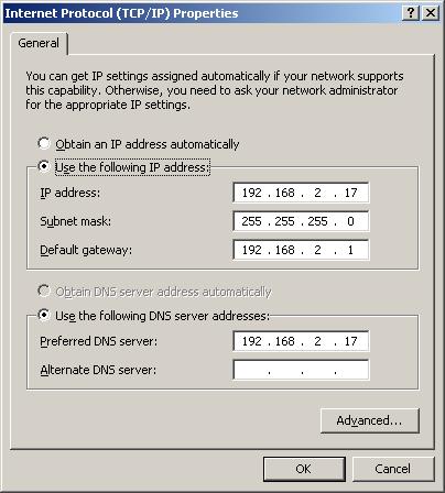

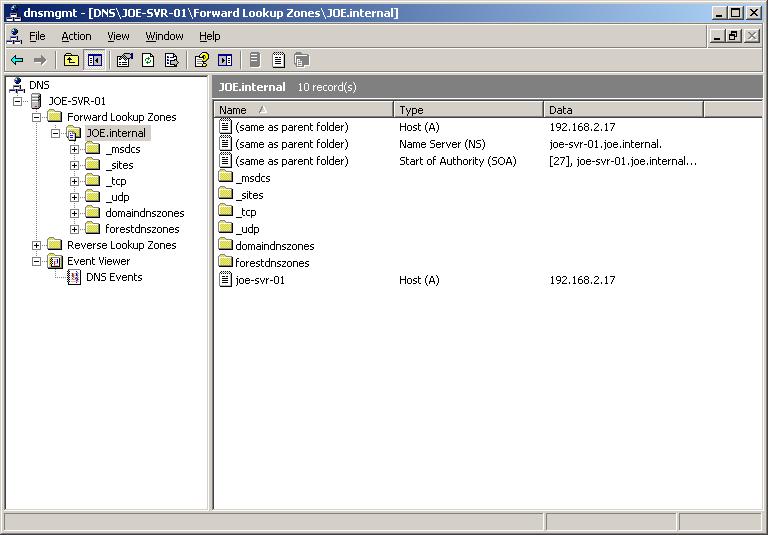

dajoebomb Posted June 7, 2008 Author Share Posted June 7, 2008 Thanks for your reply Bobbba, I think the problem may be that i do not have a reverse lookup. Can anyone advise me on how to do this i dont really understand it, i have read a lot of texts about how to set it up but i still do not understand. I have included some screenshots of my dns setup and tcp settings, i thought it might help Link to comment Share on other sites More sharing options...
bobbba Posted June 7, 2008 Share Posted June 7, 2008 reverse lookup is not really compulsory. more a nice to have. to create it, yours would be reverse lookup for 192.168.2.0 subnet 255.255.255.0 is your client's(joexpfaster) preferred dns set to the server's ip 192.168.2.17? if it isn't that would explain the problem. Link to comment Share on other sites More sharing options...
