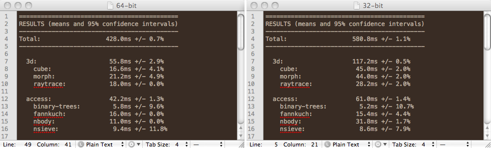

for all intents and purposes it doesn't seem as if there's much speed gain to be had by booting x64. the 32-bit kernel can still run 64-bit applications, and there isn't the hard limit with 2-3GB of RAM that windows x86/32 has.
that said, the x64 version of Safari is a beast - ran through the sunspider JS benchy in ~350ms

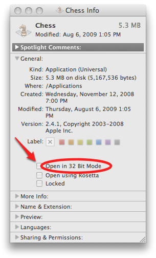

You can't mix and match 32-bit plugins with 64-bit software. Run things in 32-bit mode with the Get Info panel if needed.
I think you'd have to make Finder run in 32-bit for contextual menus to work. Which, I assume, is possible. Finder is located in /System/Library/CoreServices/ if you want to try, .Neo.
all new 64bit system apps in SL including finder can be run in 32bit mode by checking this tickbox in the "get Info" dialog box
Yea, that's what I was thinking. And I did check: Finder does have the option just like all the other 64-bit apps in Snow Leopard. We'll just have to see if it helps .Neo any.
