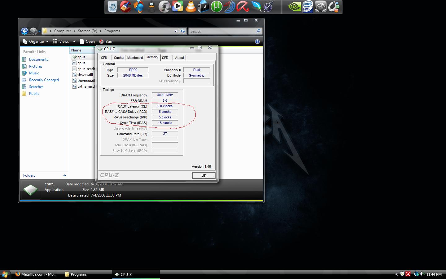

CPU-z will tell you what timings the RAM is running at.
http://www.cpuid.com/cpuz.php
okay according to cpuz the timing is set at 5-5-5-15 ? if that's correct would you recommend changing the timing to what ocz says to 4-4-4-15 ?
whats the difference ? i just don't want to ruin the memory.

i searched the official OCZ forums and they recommend the change to 4-4-4-15 and bump the voltage up to 2.1 from 1.9 for better stability. i did this and i immediately noticed a speed increase on my boot time and overall speed. what i don't understand is why the bios doesn't automatically recognize the manufacturer timings / voltages and such ? :blink:
the bios isnt written for certain ddr manufacturers. It should be able to use all manufacturers, but thats not always the case. they use the lowest setting to allow many types of ram to work.

It won't damage the ram if that's what it's rated to run at.
well it's rated at between 1.9v -2.1v. i have been told the lower i can get the voltage the cooler the ram will run. i set it back to 2.0v and i will run memtest for awhile to see if i get any errors. if i don't i will try to lower it down to 1.9v.
Mine is rated at 1.8-2.1v if I want to use the EPP profile for my ram (which is what it is sold as) I had to manually set it to the specs 4-4-3-5 2.1v in the BIOS.
And yes, more voltage= more heat. So if you can get it stable at a lower voltage thats great, but if the specs you provided earlier are correct there is nothing to be worried about running them at 2.1v
When the timings are set to Auto in the BIOS it uses the timings stored on the SPD. You can check this information under the SPD tab in CPU-z. For some reason a lot of manufacturers seem to store higher timings than what they are rated for according to their own specs.
