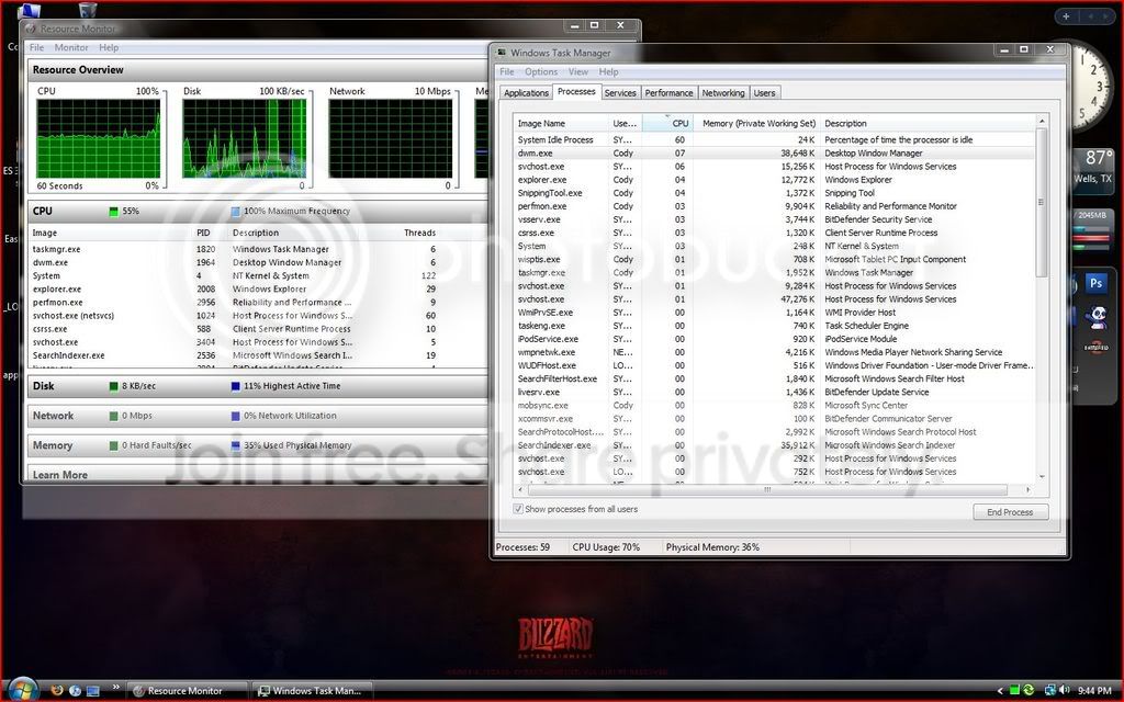

What kinds of gadgets are loaded at the time in your side bar? Have you checked your Motherboard Manufacturer for bios/driver updates?
If you can manage a little test run- Turn off the Side Bar to see if one of your gadgets is causing it. Just a thought after looking at the screenshot. I saw one once where the spike on a single cpu (though possible on a dual core) would occur each time a weather update would occur or an RSS reader gadget.

I would also try the following... Either temporarily Disable the Side Panel or turn off Gadgets one at a Time. I seem to remember a Weather one that You had to set the Polling interval so it would not update as often. Not to mention there was one with Moving Pictures That Was for MSN(WLM) Messenger. That would load up too many buddies and the solution for that one was to have it list names only. And you may say the video card is what would render it, but it would have to first get processed from the internet through the CPU before it goes to the video card.
Also can you repost your desktop with the tray extended and no windows blocking the Side panel I want to see what programs are currently running.
