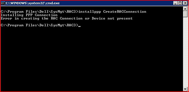

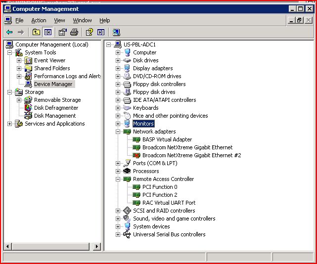

Frank Posted August 28, 2008 Author Share Posted August 28, 2008 hmm, try shutting down the server completely and pulling the power after it shutoff so the drac will hard reset. then plug the power in and boot up. that should fix it! That did the trick, I can now log into the DRAC. Now I have another issue. After I log into the DRAC interface I can't use the remote console interface. I get the following error seen in the screenshot below. I tried using the command "installppp createRacConnection" that i found on the net that could be causing this but I got the following error message. Here is a screenshot of my device manager. Any ideas how to resolve this? Link to comment https://www.neowin.net/forum/topic/660768-after-drac-firmware-upgrade-default-rootcalvin-no-longer-works/#findComment-589711176 Share on other sites More sharing options...
